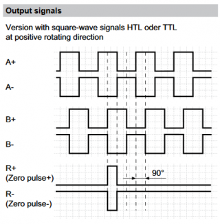

Adding 3rd output [Z / Trigger] possible?
Great work with this tester luni!
I'm just received a set of T4.1 boards and i'm new with the Teensy's.
One of the first project with T4.1 is to make a simulator for rotary encoders witch supports at least 32768 (X4) pulses per rev. and with trigger (Z) also implemented.
I'm found out that IMXRT1060RM "quadrature decoder/encoder" has a native support for home, trigger, so probably trigger can be added on this lib too? If so.. are you interested? thoughts? Ideas?
Secondly is there idea about a performance yet?
eg: with encoder type mentioned and with 25RPS we should get a 819200 transitions/s right?
I'm not sure, but believe that teensy had now enough of juice to output this pulse rate and even higher without any trouble!?
I had done past a simpler quadrature A,B,Z simulator with ESP32 where i toggling outputs with isr-timer and found out that output frequency with 32768ppr starts to come more unstable with higher frequency's.
and was saturated somewhere around my target.
ps, here's the encoders i try to simulate and they had a versions with max of 131072 ppr:
https://www.baumer.com/dk/en/product...ncoder/c/33780
-Tepa

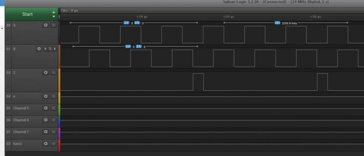

Here's a graph for showing alignment... Phase shift 90° and positive direction: zero (trigger) should should go high with B-rising and come back low with A-falling.
The start of the Z pulse obviously depends on the period ('ppr') you select. E.g., if you set the period to an odd number, the starting edge for the Z pulse will change each time, if you use a period which can be divided by 4, the pulse will always start at the falling edge of B. Real life encoders necessarily have a period which can be divided by 4. So, just make sure you set the period correctly then it will work as expected.
Here a first test result. I set the pulse rate to 800'000 pps. To display the zero pulses without zooming I used a small zero pulse period of 12.

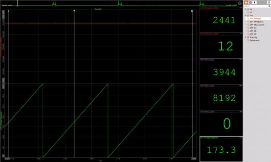

Indeed it goes up to round 2500rpm now and i think i can use it "as is" for a long time from now.
For future i'm interested how or is it possible to improve still further some show?
If i had take it correctly now hw pit timer fires interrupts to toggling gpio right?
how about if using pit against DMA for switching pin or some other technique?
Here's my measurement with top frequency setting 2500rpm i've got avg @2441 rpm and peak to peak was only 12rpm Not Bad :)
