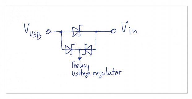

3 Schottky diodes should do it:
The upper diode from Vusb to Vin is not forcibly needed, it is thought as a helper for those who expect to feed peripherals connected to Vin from the USB supply
Thanks! This looks like "Option #3: Two 1N5817 Diodes" on the "Using External Power and USB" link I referenced in my post, with the additional diode on the top. Yes, that does look like a good solution. I do tend to rely on the 5V power for other peripherals, and as long as I can afford the additional diode drop this would appear to be a good solution. Wouldn't there be some risk that Vusb-Vd > Vin, where Vusb would start driving Vin?
Other boards have solutions to this issue (e.g., see Uno schematic). I figure there must be some really good reason the Teensy does it the way it does. It really is just a minor inconvenience for me, but I would prefer not to have to think about it at all.
The risk of Vusb driving Vin is there. But as always in life, there are no 100% fool proof solutions. In my designs, this third diode does not exist. So, either everything is powered from Vin, or Vusb is applied, just for flashing the Teensy. Vusb is never used to power external peripherals.
