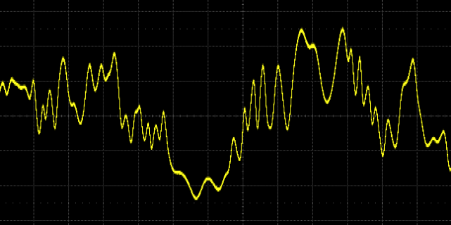

I've played with some simple FM synthesis, and reworked the PlaySynthMusic example to use it,
as well as trying to declutter all the toplevel boilerplate so it can be parameterized by a number of voices.
The way I've addressed this is to bundle all the apparatus for a voice into a class, 3 oscillators and an
envelope, like this:
// Implement an FM voice, 3 stages in the algorithm in sequence, plus the envelope
class FMVoice
public:

The FM parameters I found after a little tinkering sound fairly organ-like and are pretty funky on the 'scope!

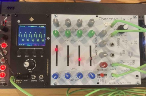

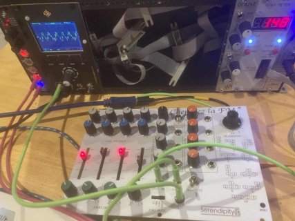

I put together a Eurorack 4-operator FM voice using parts of the Dexed audio library object.
Because I wasn't trying to recreate a DX7, I dropped various things (like the LFO, pitch envelope, detune, effects), changed others (coarse frequency down to 1/128 like the OpSix, ADSR envelopes instead of the 4-level/4-rate DX7 ones), and it's CV driven monophonic rather than MIDI.
Most of the code was pretty useful, though the highly interactive nature of my device meant I had to make changes to minimise digital artifacts and have the envelopes behave properly.
Here's a short overview and demo.
Thanks for the inspiration! :)
