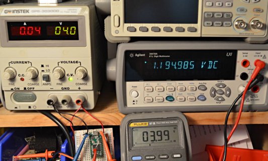

Ok, I'm trying a few measurements...
VIN = 5.00 volts, AREF(ext) = 3.26749 AREF(int) = 1.194974
VIN = 3.99 volts, AREF(ext) = 3.26099 AREF(int) = 1.194985
VIN = 3.604 volts, AREF(ext) = 3.25737 AREF(int) = 1.194972
VIN = 3.198 volts, AREF(ext) = 2.86699 AREF(int) = 1.194962
I used an Agilent 34410A multimeter to measure AREF. It was set to the slowest, highest resolution mode: "100 NPLC" (whatever that means....) This particular 34410A is about 3 years old and has not ever been recalibrated, so it's outside the recommended 1 to 2 year calibration interval. Hopefully these 8 measurements can at least be compared to each other, even if the meter itself if outside Agilent's recommended calibration interval.
I physically moved the positive lead between the AREF pad and a small wire I soldered directly to pin 17, to access the 1.2V internal reference voltage. Both were measured with the negative lead to AGND.
I used a Fluke 87-III multimeter to measure VIN, relative to GND. The power came from GwInstek power supply.
Here's a photo of the test setup.
(click for full size)
Paul -- 'NPLC' is number of Power Line Cycles -- the number of 50/60 Hz cycles over which it measures -- this filters the effects of interference picked up from AC power lines. So 100 PLC takes 100/60 = 1.67 seconds per measurement.
Your measurements on AREF(int) are within the specified range (1.195 V +/- 0.2 %).
The AREF(ext) is not intended to be accurate -- it is also operating within specifications. From VIN falling from 5 V to 4 V, it changed by less than 7 mV, or also 0.2 %
