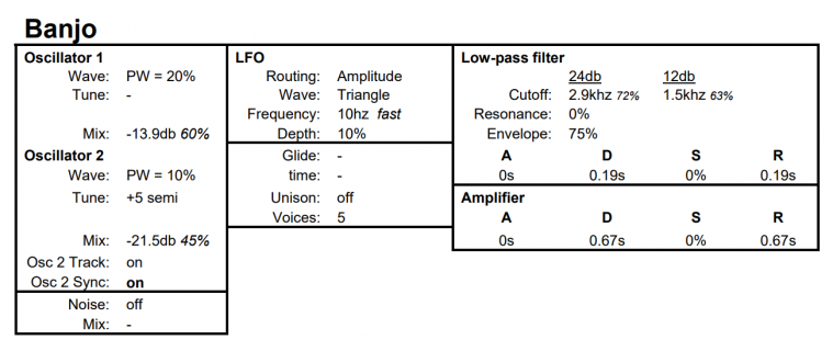

Hi Emmanuel,
I have been working on my synthesizer over the past month. I have implemented much of Ken Wessen's constructive synthesis tutorial onto a project. Again, thank you for this valuable resource. Notes are triggered via an additional envelope, and it implemented as you described in your older post.
Things like Velocity sense, Overdrive, pitch are not implemented from the features of the "mentor" synthesizer of the tutorial (image below):
At this point, I want to make my synthisizer "patchable" or have presets. What I mean is I want to make it so that I can set certain parameters at get a certain type of sound, such as a piano or a flute.
In your Minitouch, you have much of these settings, but your sound generation comes from a sound preset, not an oscillator. In the second version, you have some software that allows for tweaking the sound
Below are some examples:
Source
Source
Right now I have two oscillators, that can be morphed between a sine,saw,triangle, or square. How can I make a richer sound?
Also, what is the point of polyphony other than playing more than one note at a time? From what I can tell it is just a way to play chords. Does it help in any way for sound synthesis?
I know this is alot of questions at once. Please take your time to answer them. Thanks in advance!
