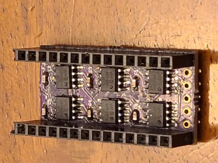

Wanted to let folks know that I was able to successfully get 6ea CY15B104Qs on Franks memory board and can now delay/loop >35 seconds of audio! :) There were hurdles:
* To solder the (wide) chips to the board I bent the leads under and soldered carefully. A scary proposition with these expensive parts. But done in the right order and checking work under a microscope, it can (does) work.
* I updated the lib for another type to allow for this config. That's archived here:https://github.com/SensoriumEmbedded/Audio

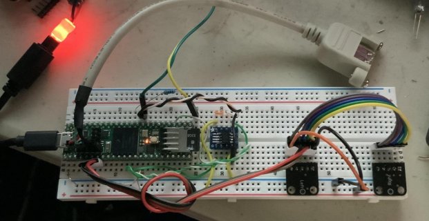

I made a memory board and am not able to get it to work. I am using it in conjunction with the multichannel tdm board. The code loads without any problems. When I replace my extended delays with typical delay, then the delay works, but when I use the extended delay, there is no delayed signal in the output. Also btw, I am using 6 23LC1024 chips on the board and as far as I can tell all my solders look clean and the board is oriented correctly. The board is mounted on top of my teensy 3.6. Any help solving this issue would be much appreciated.

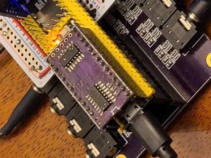

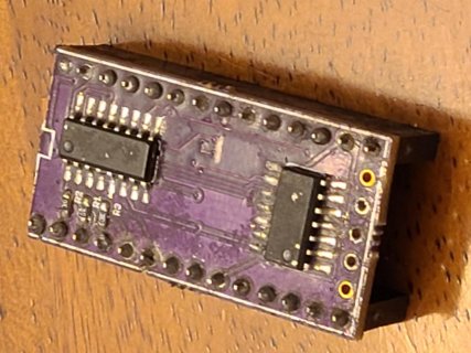

here are a few pictures of the hardware

Also, I'm fairly confident that Frank's Memoryboard could hold 6 x 8MB (48MB or 9.5 minutes of delay), but I don't need that that much delay loop yet, so holding off on that thought for now.
Here's the board with SOIC adapter. I also turned up the SPI speed to 90000000 without ill effect, so external delay object initializes much faster.
You can see the SPDIF3 output via LED (the yellow and green wires going off the top of board) and the MEMS microphones I'm using on AudioInputI2s2
