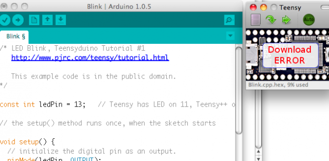

Paul, just wondering if you have any idea what is going on?
(Arduino 1.0.5, Teensyduino, Teensy3)
Here is the trend.
Teensy3 is not visible in serial port.
I click upload, it asks me to reset the board.
I reset, Teensy3 is now (magically) visible in serial port.
I proceed to upload, receive error 'download error' from teensy loader
Teensy3 vanishes from serial port
Uploading/rebooting all prompt 'download error' (see image)
Just trying to upload the blink code as a test.
This Teensy3 was working perfectly a few hours ago and I am measuring 5V across it.
Restarted my computer, everything went back to normal.
Teensy3 is working fine now.

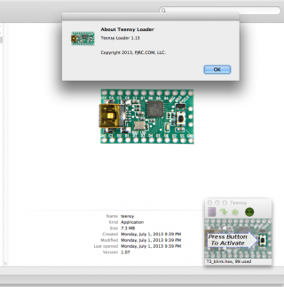

This is a very small bug that is not limiting function but can be a bit confusing.
The info.plist fine in the teensy 1.15 loader app still lists it as Version 1.07.
So when you start the app manually and select "Teensy" --> "About" it'll still show the correct version 1.15 but in Finder it shows 1.07.
If that's corrected in te info.plist file it will also show correctly in the Finder.
Opps. Thanks for reporting this, with the nice screenshot. :)
I've added this to my bug list to fix on the next release. I have a script that auto-updates this for the Teensyduino installer, so it should be pretty simple to apply it to the Teensy Loader build too.
