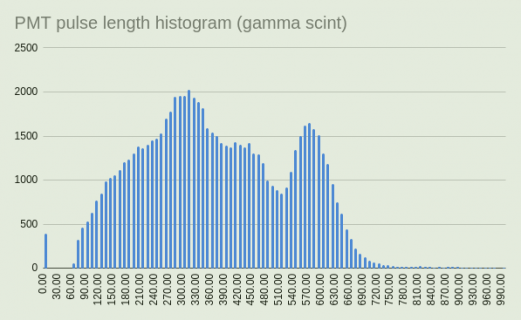

I'm wondering if you might comment on what I'm seeing. I have pulses typically around 5 microseconds in length, on average about 20 of them per second, but each one arrives at a truly random time (this is a gamma scintillator, timing is random like a geiger counter). My code nominally works as expected, giving me measurements of a few hundred counts per pulse, but occasionally I see big numbers like 4 million which I do not think is possible from my hardware. What happens if two pulses are very close, like 50 nanoseconds apart? Is there a problem when a pulse arrives during the interrupt routine? I have a T4.1 board around somewhere but can't find it, so at the moment I'm running this on an old Teensy 3.2 board.

In case of interest, here's a histogram of pulse lengths captured by the above code. In this case, pulse length is some function of gamma ray energy, and the rightmost peak around 580 counts on the horizontal axis is due to a small Cs-137 test source emitting gammas near my detector. The isolated column at 0 in this case corresponds to these huge numbers mentioned above, a situation I speculate might be caused when pairs of pulses happen to occur too close in time to each other.

Update: I found my T4.1 board and ran the same code on it, with the same source signal of pulses. The T4.1 has higher resolution by counting a faster-running clock. It still has the too-large-number glitches described above, but they are far more rare; only two cases out of over 30000 samples. When they do occur, they are enormous numbers, like 4 billion.
0,4294951842
0,4294953093
This makes me think of 32-bit overflow, because 2^32 is about 4.295 billion. So it's like an interval got swapped and instead of computing a duration as (T2-T1) it's instead finding (T1-T2), but the result is an unsigned type so instead of a small negative number, the result is a huge positive number near 2^32.

Yes, I think that could happen if intervals are too close together. The value that is captured on the interrupt is a running 32-bit timer, and the ISR computes the delta (period/high/low) and writes that to a queue, so if periods were too close together, there must be a mixup in the "current" and "previous" values. I'd have to review the ISR in the FreqMeasureMulti to be any more specific, but maybe that's not important, since you can work around it? I don't know why the T3.2 would have a value of around 4M in these situations instead of also being around 4B.
On the T3.2, the large numbers near 4M would make sense if instead of + pulse width, it was counting - pulse width (duration from falling edge to next rising edge). It works out to be about right for the typical interval between pulses, which often come about 10 to 20 per second.
