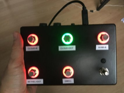

Hi I am new in the forum and new to coding. Bought a 6 button midi controller and was trying to code. Manage to add 2 different midi channel into the code.
The mid controller works in way that when I switch on button 1, I need to off button 1 in order not the mess up the PC number.
How can I switch on a random preset (e.g. button 3) without needing to off it.
For e.g. When I switch to button 4, button 3 will off it and button 4 preset will come right up.
Any help appreciated.
Thanks!
Thanks!
