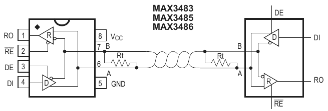

3. RO & DI pins of MAX3485 are connected to Modbus device (here the Angular transducer).
That's not right.
The MAX3485 RO & DI pins are supposed to connect to Teensy. You need to connect MAX3485 pins A & B to the Modbus device.
Maybe this diagram from page 8 of the MAX3485 datasheet can help?
Also see the connections I suggested in msg #8.

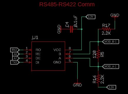

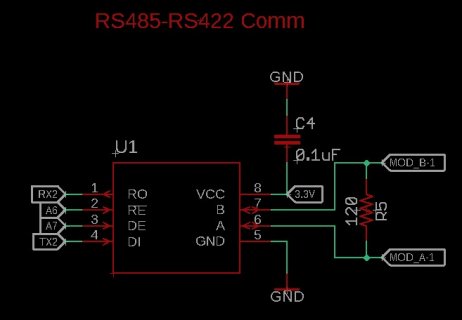

I am trying to establish MODBUS RTU connection with MASTER PLC using Micromod Teensy, but I was not successful. I want to make a connection via Serial2. I changed the RS485.h and RS485.cpp files as follows.
#define RS485_DEFAULT_TX_PIN 17
#define RS485_DEFAULT_DE_PIN A7
#define RS485_DEFAULT_RE_PIN A6
RS485Class RS485(SERIAL_PORT_HARDWARE1, RS485_DEFAULT_TX_PIN, RS485_DEFAULT_DE_PIN, RS485_DEFAULT_RE_PIN);
I have stated the scheme I used below.
In the scenario, the master device needs to read a series of data from the teensy. Can you share me a sample code? I couldn't understand the examples found in this library. I get the "Invalid CRC" error in all my attempts.
Hello,
Finally I solved the problem. The "milesg" approaches in the link below helped me solve the problem. In the MAX485 or MAX3485 IC, it is necessary to make output A pullup and output B pulldown. During the testing phase, 1k resistor was enough for me. (2.2k in design) I connected a 120 ohm resistor between A and B as stated on the information page. I made this communication via Micromod Teensy and used "Serial2". Here I used pins 21 for DE and 20 for RE. I also used pins 17 for TX2 and 16 for RX2. However, I could not transfer data at speeds above 57600 baud. It is necessary to make the first attempts with 9600 baud. The circuit I designed would work as a slave on Modbus and communicate with the CM1241 module on a SIEMENS 1200 series PLC. On the CM1241 module, I connected pin 3 to output A and pin 8 to output B.
On the software side, I used the "ModbusRTUSlave by C.M. Bulliner" library and was successful.
The pin numbers I mentioned above belong to Micromod Teensy. Pin numbers for other Teensy cards will vary.
