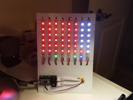

I am interested in this thread since I believe I am having the same problem. In my case, it is the first LED in each row. The Basic Test program seems to ignore the presence of the first led in all eight rows. Changing the ledsperrow value confirms that row 2 is being seen as row 1. I have no intention of hijacking the thread, just adding data to it. My LED on Pin 13 remains off.

I will give that a try this afternoon. Below is a photo of the test bed I set up. The first LED of each strip (bottom row) randomizes at each power on.

Also potentially useful here, do you have any markings or ordering information on what these LEDs actually are? There are several flavors of similar but not identical serial LEDs around. Since the LEDs reshape the signals as they pass through it's not impossible that there is something amiss with the timing of the first pixel, which it reshapes and then passes on correctly.
The LEDS are fresh from SparkFun and labeled as WS2811. I seem to recall that they have a "direct drop in replacement" and perhaps that is what was in the bag. I will look to the strip itself to see any identifiers.

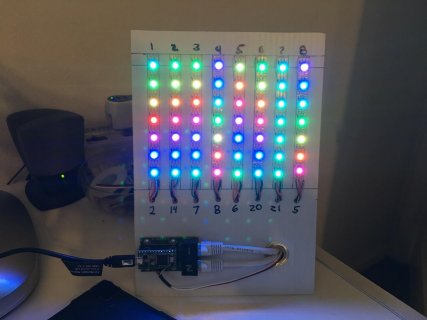

I loaded up test files with Neopixel and FastLED libraries and ran each test on each pin (16 tests). All led strips work individually on each library.

Thanks for taking the time to run the strip tests since that pretty much nails this as something to do with OctoWS library and how it sends the first block of data. Since if I'm reading the data sheet right the scheme is that each pixel grabs the first 24 bits of data and then latches it, passing all future bits along until 'display' is sent when they all update. So something is stuffing the first block sent.
Pending answers from the code an interim option is https://github.com/FastLED/FastLED/wiki/Parallel-Output
This loses some of the parallel processing performance that OctoWS library gives, but if you are just driving lots of pixels, without needing to extensively pre process them may get you where you need to go without having to untangle what has changed in the OctoWS DMA source code.
