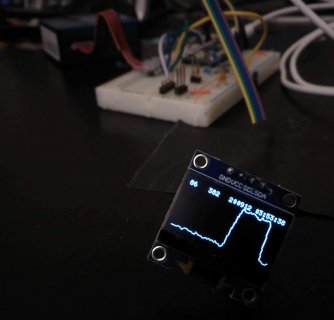

Photo shows a T3.1 hooked up to a Plantower PMS5003 air quality particulate sensor https://aqicn.org/sensor/pms5003-7003/ and a small OLED display to graph the reading vs time. I had it inside, took it outside briefly and then back inside. When I first tested it a few months ago, the reading was about 3 to 5 units in the PM2.5 bin (it also has other size ranges).
With the current fires near Portland this evening of Sept.11 it reads around 90 indoors and 380 outside. Right now I'd say it smells like "nearby campfire". I didn't have it running yesterday when the smoke outside was far worse, like "inside a wood stove chimney". Teensy is running this code: https://github.com/jbeale1/DataAcq/blob/master/PMS5003-OLED.ino

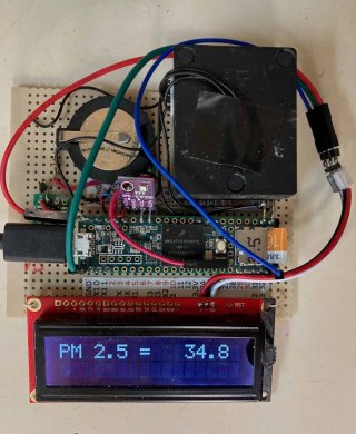

I've had a Honeywell particulate sensor connected to a T3.5 data logger for a while now. I used the PM10 data to keep track of allergens--grass pollen is a real problem here in the Willamette valley (The grass seed capital of the world!). When the smoke started getting thick, I added a serial LCD display so I could plug the system into a portable USB charger and check out the PM2.5 levels around the house.
Here's the setup:
The logger also has a BME280 module to collect temperature, relative humidity and barometric pressure.

I've been spending most of the day in the computer room (my 15' x 21' home office). The filters on the furnace don't remove small particles at all, so I don't bother to run it in 'fan only' mode. I move the portable HEPA filter from the computer room into the bedroom at night and it brings the particle count down under 100 in an hour or so.
The 34.8 number in the first photo is down from the 125 found in the computer room after I moved the HEPA filter to the bedroom overnight. The PM2.5 should be down under 20 most of the day as long as I remember to keep the door closed.

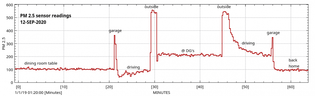

Using a T4.1 with its handy built-in SD card holder, I made a data-logging version in a cardboard box, and it went on a trip in the car to DG's ("doting grandma") place and back, and sure enough there is a reason that her eyes are watering.

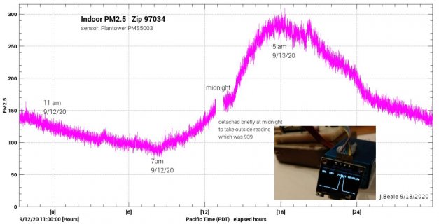

Interesting to see how things change over time, with the sensor in one location in the living room. Inside reading peaked this morning near 300 around 5 am. If I had a continuously running outside one as well, I guess I could figure out how much external airflow gets into the house.
