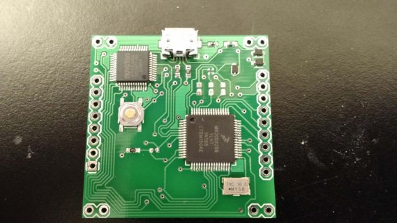

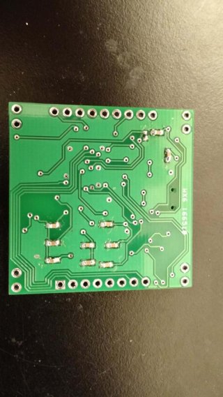

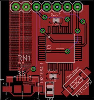

In an attempt to start developing in Cortex-M4, I've been working on trying to make a Teensy clone using Paul's MINI54 bootloader chip and the Teensy's MK20. This custom PCB is a square and loose rendition of the original. I assembled the components first using solder paste, and then used an iron and some wick to get rid of the excess bridges on the two main IC's. I've attached images of the board in this post.
At first, I plugged it into my machine and loaded a simple blink sketch to test if it would load code. It was unresponsive and the Teensy loader did not show up. I then reworked the pins manually by chasing solder across the pins to make sure that they were all well connected. Afterwards I plugged the Teensy back into my USB port, and it loaded the code! The Teensy loader showed up, I pressed the reset button, and the loader displayed "Reboot OK".
However, when I went back to test with a multimeter for whether the broken out GPIO were actually working with the blink sketch, they were either floating or completely 0V. Pins 14, 15, 16, 17, 20, 21, 22, 23 were broken out and tested with the blink sketches, with no signs of life. Another thing I noticed when I went back to the IDE, is that the USB port with a specific number was never picked up. It is as if the code was "loaded" in software, but not physically loaded into hardware. The loader confirms that the reboot is OK, but the Teensy itself is not functioning as if has been programmed. What accounts for the software saying that the code is loaded in the Arduino IDE with Teensy loader but the custom PCB itself not functioning?

As I understand things, the bootloader on the Cortex M4 and is coded as a USB device, so the USB is really running on the M4.
If the PC loader is happy then there must be a functional program capable of USB communications running on the M4.
This would mean the M4 is not dead and can run code, but there might be other problems that shows up when initialising the
Teensyduino libraries.
Please post a schematic.
From the pictures it looks like there is no connection from 3.3V to VBAT (Pin #21 from the MK20DX256VLH7).
Hi guys, thanks for the fast responses!
mlu: I think what you're saying sounds right, since the USB data lines are connected directly to the M4. What kinds of problems do you mean?

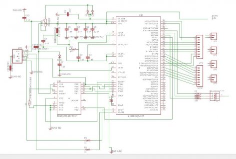

HWGuy: Thanks so much, you're right, pin 21 isn't connected to 3.3V. Would that do the trick? I will try manually connecting VBAT to 3.3V. I've attached the schematic. I'm assuming there are more potential mistakes. Now that I've looked at the schematic, VBAT is directly connected to ground, which doesn't seem right at all. Thanks for all of your help guys! Really means a lot.

Yes VBAT needs power (Min 1.5V).
From the Ref Manual
Any attempt to access an RTC register, except the access control registers, when VBAT
is powered down, when the RTC is electrically isolated, or when VBAT POR is asserted,
will result in a bus error.
The Teensy startup code (in mk20dx128.c) does access the RTC register.

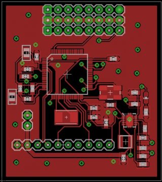

What I could see from the schematic/pictures:
Missing connection from R6/C3 to VREF-H on the pcb. The schematic doesn't look right. Usually there's a big dot for the connection of the 3 wires.
Minor "mistakes"
  • do not route signals (D17) below the crystal. For more information see chapter 2.1.3.3.2 from the Kinetis Quick Reference User Guide
  • unnecessary diode D3.
  • unnecessary wire from P3.4(MINI54) to D7.
  • place the decoupling caps closer to the ic pins/pad.
  • Keep traces short. Why is Ferrite3 so far away?

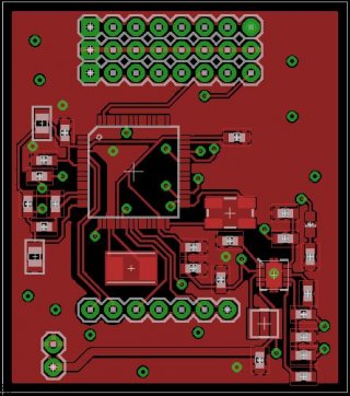

Concur. Some additional points:
Ground plane is largely missing. IMO, that's trouble! At the very least you need a ground plane under the crystal that is attached to VSS on the pin next door to help shield the crystal.
I'd place the de-coupling caps on the same side as the MCU. Less work if you ever reflow solder.
I don't see the point in having the Mini54 where you have it. The long snaking digital lines = trouble. Put the Minitan54 at the bottom of the MCU, use the QFN 5x5mm version. Much easier to implement and smaller. Library is posted here.
No need for the SDA/SCL connection between the MiniTan54 and the MCU.
Ditto for Pin4 on the USB connector (can be grounded), unless you plan on implementing a USB host adapter.
Most signal routing issues are non-critical, expect the crystal.
You MUST NOT have any digital signal routed underneath the crystal. A digital signal switching underneath the crystal will cause reliability problems.
If you have 4+ layers, it's ok to route stuff on the lower layers, as long as the layer directly underneath the crystal is a ground plane.

Hi everyone!
I just wanted to say thanks so so much for all of the help. It's really tremendous. I'm now going back and redesigning the board a bit with all of your feedback, so hopefully I'll have something soon. Again, can't thank you all enough.

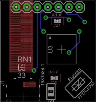

Again, thanks so much for all the feedback! I've taken it and to the best of my abilities made corrections. I've made another version of a clone Teensy, albeit with the enormous help of Phillip Schuster of Appfruits. I used his schematic for the new board in his article. Please check him out here, this article truly is a gem:
http://www.appfruits.com/2015/03/building-your-own-custom-teensy/
In this version I took a bit of a twist and I decided to separate the MINI54 and the MK20 on two different boards. The gist is that the bootloading board can be plugged into the other MK20 board for programming and removed afterwards for smaller footprint when the MK20 itself is in use in a project. The board features the TI TPS61202 switching power regulator at the bottom right of the MK20 board, as it will be fed with a 3.7V lipo. Also, the header that connects the two boards is slightly "inland" on the MK20 board so that 90 degree female connectors are flush with the edge of the board.
I made sure that the USB wiring is as nice as possible with regards to differential pair wiring even with the two boards coming together with headers. Also, I made sure this time around that there are no signals running under the crystal, and also added a RT crystal. Also fixed design so that all of the supply pins have decoupling caps nearby as opposed to my labyrinth of wires in the previous board :)
