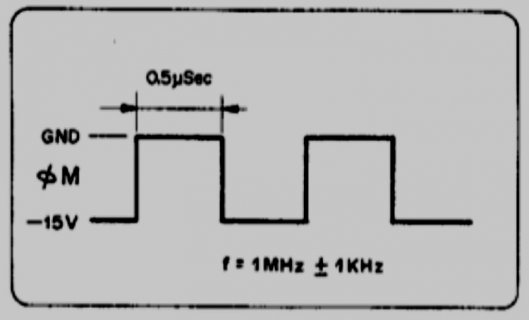

I'm very new to teensy but thought it could help me with a midi retrofit project.
I chose the Teensy++ 2.0 due to the 5V tolerance & the number of digital I/O's. I'm working with a Keyboard/Organ that I'm hoping to interface the teensy into by means of reading its (the keyboard's) clock signal. *This is so i can spit out logic signals back to the keyboard.
The clock signal is 1Mhz, that swings from -15V (Low) to 0V (High), the High & Low cycles each 0.5us. *see attachment
I figure i will just need to do a simple resistor voltage divider to get that -15V (low) down to -5V, but will I also then have to invert the voltage to +5v with an opamp, or can the Teensy++ 2.0 handle negative voltages on it's I/O pins?
Just so I know I'm not barking up the wrong tree, this board should be able to track/follow a 1mhz external clock?
Thank you
No. The pins only work with 0 to 5V signals. Driving the pin below GND can damage the hardware.

Hey Paul,
Thanks for the reply, shouldn’t be too hard i guess to get it into 5V logic.
Regarding the timing, the 1uSec master clock i believe is divided down inside the cmos chips after studying related service manuals closer, i think the note timing is more like every 3uSec (per note), and its sent as a 4-bit parallel data code.
I’ve got a 20mhz scope on the way so i’ll be able to tell in more detail.
But the way i believe it acts is that for 14-note polyphony, a sync signal is sent out every 42uSec, and within that period, every 3uSec a 4-bit parallel code is sent for each of the 14 voice/note channels that corresponds to note and octave data.
Given those conditions, should the teensy++ be able to handle the task Vs every 1uSec?
Thanks
Actually i got that wrong, i think it does need to send out a 4-bit parallel code every 1us. Its just does so using 3 nibbles over a 3uSec period (touch data -> octave data -> note data (c# to c).
Maybe i’ll have to create an array to speeed things up.
That being said, no one plays keyboard at that rate, its more for communication timing when a note is detected.

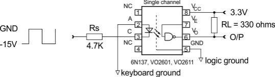

I wonder if a 6N137 optcoupler would work as your level shifter. It may work at 3.6V for Vcc, although the datasheet says 4.5V minimum. It would provide ground loop protection for your keyboard.
That opto is too slow. I was thinking of a 6N137M. You may need to fiddle with the resistor values to get the desired rise/fall times. Also, it is uncertain as to how much delay this circuit produces to make this not work for you.
Edit: This circuit will invert your input signal. Will it matter?
Inverting shouldn’t be a problem, just a change of logic in the teensy code.

I didn't do any testing, but drew the diagram to provide a proof of concept. Your selection of a high speed opto is better since it is designed to work with 3.3V.
The 330 ohm was an arbitrary value I picked. The datasheet you just gave uses 350 ohms for the pull-up resistor of the opto's output (e.g. Fig 11). The input to the micro will not draw much current due to the high input resistance. It's the output pin that you are probably referring to for a max of 25ma.
