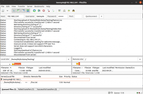

I've ported and will create a new FTP_Server for Teensy 4.1 QNEthernet, as well as many other boards, using WiFi, Ethernet W5x00, ENC, etc.
Tested so far OK with QNEthernet, RP2040 W5x00, etc.
Will try to publish the new library within a week.
The new FTP_Server_Teensy41 has just been published to support Tensy 4.x using QNEthernet, NativeEthernet or W5x00 using Ethernet_Generic Library
It's currently supporting SD card, using SDFat. The LittleFS, other FS using (Q)SPI Flash will be added gradually.
Please check, test and report any issue.
Starting FTP_Server_SDFAT2 on TEENSY 4.1 with QNEthernet
FTP_Server_Teensy41 v1.0.0
Initializing SD card...
Wiring is correct and a card is present.
Card type: SDHC
Volume type is FAT32
Volume size (Kbytes): 31452672
Volume size (Mbytes): 30715
SDCard Initialization : done.
test.txt                                      1048702    22:42  April 29, 2022
foo.txt                                            13    00:00  January 1, 1980
datalog.bin                                  41943040    00:00  January 1, 2022
index.htm                                        3810    22:50  April 29, 2022
mydatalog.txt                                      10    22:24  April 9, 2022
edit.htm.gz                                      4116    20:15  March 13, 2022
CanadaFlag_1.png                                41214    20:15  March 13, 2022
CanadaFlag_2.png                                 8311    20:15  March 13, 2022
CanadaFlag_3.jpg                                11156    20:15  March 13, 2022
favicon.ico                                      1150    22:54  April 29, 2022
graphs.js.gz                                     1971    20:15  March 13, 2022
CanadaFlag_2_1.png                               8311    22:52  April 29, 2022
ESP_AT_WM_Lite.txt                               1547    22:51  April 29, 2022
done!
=========== USE_QN_ETHERNET ===========
Initialize Ethernet using static IP => IP Address = 192.168.2.241
FTP Server Credentials => account = teensy4x, password = ftp_test
[FTP]  Ftp server waiting for connection on port  21
[FTP]  Client connected!
USER teensy4x
PASS ftp_test
[FTP]  Authentication Ok. Waiting for commands.
SYST
DELE test.txt
PORT 192,168,2,30,169,133
[FTP]  Data IP set to  192.168.2.30 , Data port set to  43397
LIST
DELE datalog.bin
PORT 192,168,2,30,135,195
[FTP]  Data IP set to  192.168.2.30 , Data port set to  34755
LIST
PORT 192,168,2,30,165,55
[FTP]  Data IP set to  192.168.2.30 , Data port set to  42295
LIST
PORT 192,168,2,30,206,193
[FTP]  Data IP set to  192.168.2.30 , Data port set to  52929
RETR index.htm
[FTP]  Sending  index.htm
PORT 192,168,2,30,182,29
[FTP]  Data IP set to  192.168.2.30 , Data port set to  46621
STOR index1.htm
[FTP]  Receiving  index1.htm
[FTP]  Transfer completed in (ms)  250 , Speed (kbytes/s)  15
QUIT
[FTP]  Disconnecting client

Hi Electrolyt
Thanks for testing.
The passive mode is working OK here. I'm testing using Ubuntu pftp or ftp -p. The default data port is default at 55600 in passive mode, instead of 20 in active mode. But you can change the passive data port via the following command in the example
// Object for FtpServer
//  Command port and Data port in passive mode can be defined here
FtpServer ftpSrv( 221, 25000 );
// FtpServer ftpSrv( 421 ); // Default data port in passive mode is 55600
//FtpServer ftpSrv; // Default command port is 21 ( !! without parenthesis !! )
For the SD card, I just take from the example listfiles of Teensy SD Library and have no issue here. Can you test listfiles or add some delay, etc. to fix the issue.
That file-listing feature is only optional.
I'm testing now using FileZilla v3.46.3 and OK in passive mode

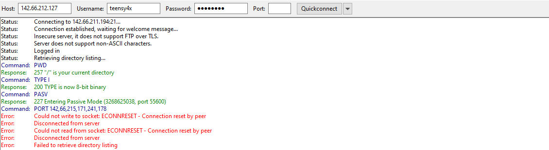

Hi khoih-prog
thanks for this library
i initialized the FTP server object as FtpServer ftpSrv
I am running the FTP_Server_SDFAT2 example
and I am trying to connect to this server using FileZilla
however I get this error in FileZilla
this is the arduino serial monitor
Starting FTP_Server_SDFAT2 on TEENSY 4.1 with NativeEthernet
FTP_Server_Teensy41 v1.1.0
Card type: SDHC
Volume size (Kbytes): 30522368
Volume size (Mbytes): 29807
System Volume Information/
  IndexerVolumeGuid                                76    14:22  June 1, 2022
WS01.csv                                         1032    16:32  June 1, 2022
mtpindex.dat                                        0
SensorData/
  WS0.csv                                        3119    13:56  June 2, 2022
  WS1.csv                                        8562    13:47  June 2, 2022
  WS2.csv                                        8564    13:53  June 2, 2022
done!
======== USE_NATIVE_ETHERNET ========
Using mac index = 9
Connected! IP address: 142.66.212.127
[FTP]  Connection management set to passive
[FTP]  Listening at  142.66.212.127 : 20

Hi microguy
so with other ethernet libraries you were not seeing this issue? if so is it the QNEthernet library that works with this?
I tired with the older filezilla 3.46.3 version also but still get the same error
thanks
Yes, I tried with QNethernet, and it's working. work in active or passive transfer. for passive transfer, if you use Filezilla on windows, you need to be careful with firewall! (I tried FTPRush too)
But as I have other part of my software that run with nativeEthernet, I think I can't easily use Qnethernet .
I use Filezilla 3.60.1.

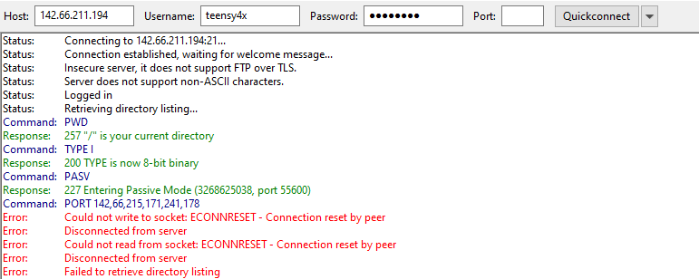

OK, I tried with Native Ethernet and it seems that the problem is not exactly the file or folder size but the number of file, you can't have more than 14 files in your root directory.
but I get ECONABORTED error now. Do you know what might be going wrong here?

I'm setting up Filezilla like you, so I Think the problem is only the firewall config. On mine, I deactivate it for all private network (but my test computer is only connected to Teensy).
