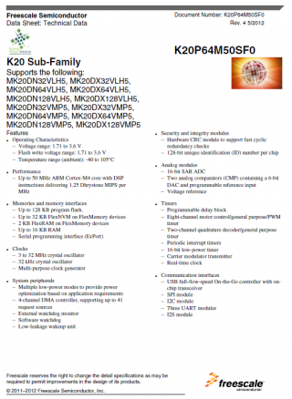

Does anybody reading here know whether features not explicitly mentioned in this table (for instance CRC or RTC) are present in all K20_50 chips? (Neither term seems to be evident on that webpage.) In the case of the RTC, we know from *Paul's documentation* that our chip really has the RTC implemented and brought out to pins. From Freescale's docs, that info seems only evident from scrutinizing the pinout table. (And for the CRC unit, which has no associated pins, its presence/absence is even less clear, to me at least.) I'm getting a headache looking through all the alternate functions on all the pins of our chip; such is tech life....

The datasheet lists all major features of the IC -- this datasheet covers different variations on the part -- different memory sizes, different packages, and different operating temperature ranges etc. on the attached front page, teh RTC and CRC are listed -- these are on all versions.
