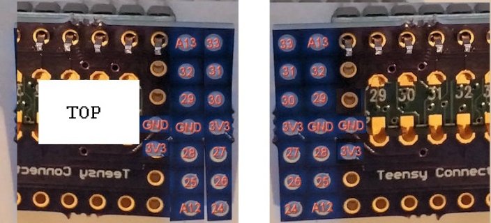

I was thinking today, how to get access to ALL the pins, easily?

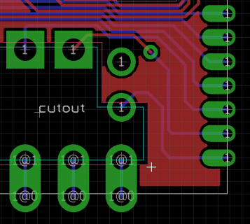

Has anyone tried to surface mount an entire teensy right on to a board?

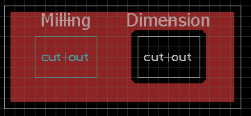

I am thinking you could make a board layout with a cutout under the teensy, and castellation on an peninsula of the PCB to get to the underside pins...
Any thermal considerations which might cause problems? This would be a permanent attachment of course, but if a breakout board was made, you could get access to all of the teensy pins with much less work! (maybe)
