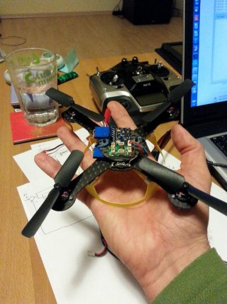

The mini flies. PID's not changed. Graupner SUMD protocoll added :)
The parts are:
- Teensy3.1 flight controller
- Graupner Mx-12 with GR12SH+ (I've forked cTn's software for my experiments)
- ESC XP 3A 1S 0.7g
- HobbyKing AP-03 7000kv Brushless Micro Motor
- Frame: 1,5mm CFK (wood may also work)
- Sensor: GY-86
- LiPo: 1S, 750mAh
Please ask google for the price of the parts.
Wheigt is <70g (I've test 20g additional load). Size, motor to motor, is 10cm. Nice to fly inside the house, especialy when it is cold outside ;)
