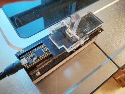

Hello! Me and some other folks are working making a hand-held, open source device which can measure plant photosynthesis. This device will ultimately connect to a cell phone to allow for easy display of results and to transfer the data into a global database of plant information sharing. The idea combines big data (combined, global, plant health data in the field), citizen science and education (engaging the public to take part in real research), and genuinely useful research in a new and unique way. There's a number of awesome new citizen science projects happening which follow the same idea (see American Gut project and the guys at Public Laboratories are two great examples). Our project is called Photosynq and is located at www.photosynq.org, and we keep files and more info at the project management page at Open Design Engine here.
Anyway, shameless promo out of the way, we're using the Teensy 3.0 to control the LEDs and to take data from the detectors. You can find a pretty good description of the types of measurements we're interested in taking at a commercial version of similar (but pretty expensive and not very open source but they have a great explanation page) equipment here. The short explanation is:
1. We pulse LED light at a plant leaf.
2. The light is processed by the leaf in 1 or 3 ways - 1) the energy is dissipated in the leaf (heat), 2) the energy is used by the plant for useful stuff (making sugars and growing), or 3) the energy is absorbed and re-released as infra-red light in the 700 - 800nm range. This 3rd process is called "fluorescence" - if you don't believe me, see this picture using an IR filter. The leaves are so bright because they are fluorescing - aka emitting IR!
3. We use a detector to measure the leaf's fluorescence response.
4. Based on that response, we can calculate how much light the plant is able to absorb and use, how much it's using right now, and lots of other fundamental and truly valuable stuff.
There's other kinds of measurements we'd like to take with this device besides this, but this is a good start.

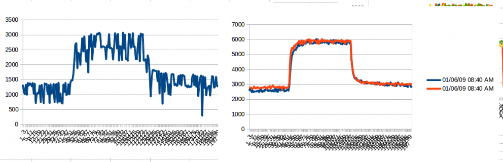

Phew - sorry it took a few days to respond, been trying to work on this to get some worthwhile numbers to share.
Thanks linuxgeek! In our group we have some good expertise but not a lot on the arduino coding side of things, so I'd really love help and ideas on how to make things faster/cleaner/easier.
Here's what I came up with (see code below), based on comments from the thread and my own ability (or lack thereof). Basically, it's just a for loop to define how many OFF/ON cycles light cycles there are, and then I stuff as many analogReads as possible on the ON cycle.
I am pretty sure the right way to do this is with interrupts and timers, like the PITimer here https://github.com/loglow/PITimer, for all the reasons previously suggested but I can't even get his loglow's example to work. Also, linuxgeek your totally right about the sd card - I've found I can store about 1000 analogreads before the arduino just locks up (presumably not enough memory?). Plus, the transfer rates (read write) for the SD cards on the 48mhz teensy are in the 1 - 5us range which is pretty darn fast.
So possible improvements: try a timer-based interrupt to free up clock cycles and add precision, decrease analongRead time to get more reads in a single ON cycle, decrease the time it takes to save the data somewhere (sd card?).
Ideal: It we could get the program to turn on an led, do at least one analogread, then turn off the led all in 1us then turn it off for 1us and repeat that cycle a few hundred times AND store the read data AND make it relatively easy for standard arduino users (not super-arduino users) to code perhaps by making a library or something - now THAT would be awesome! ... any suggestions?
** To measure the actual analogRead times, you'll need an oscilliscope. See the full file here https://opendesignengine.net/documents/15 for all the gory details.

Ok - we made some progress. Now I've got code which:
1) takes analogread()s pretty fast (by setting analogreadaveraging to 1 as suggested) - it takes only a few us per read.
2) can save data to the SD card - each write or append takes about 20ish us (actually, when you do file.print(O_WRITE) it's pretty slow to set up, but after that any file.print(O_APPEND)'s that you do are around 20us).
3) create a folder structure on the SD card and auto-create new folders so the user can effectively append existing experiments or create new ones.
4) has a standard calibration routine (calibration not currently enabled, but once we reduce noise on the analogread it will be) and user options for running the protocol and saving the data.
I know it's not optimized - I'm really barely an Arduino programmer, let alone C or C++, so I managed to get through it but I'd love any feedback. The entire code is posted here, but I hope to get it up on Github soon to make collaboration easier. Also, posted on our website with a quick update here.
The SD card is the standard PJRC version which you buy through their store, and it's hooked up as per this post - http://forum.pjrc.com/threads/16758-Teensy-3-MicroSD-guide .
In the long term, the right solution is to create a library for each of the subroutines I think... but I'm not sure. I'd love to get any thoughts/feedback/suggestions, especially as it relates to improving speed, performance, simplifying the code, or removing parts of the code which may result in lockups or other issues.

Have you looked at any of the RTOS's? I use FreeRTOS_ARM and it has some simple examples that help with the analog reads and sd card saves that might be of some use.
Nice progress.
If I read it correctly, you could do a lot more tests and write each result to a buffer. Then write the buffer to the sdcard after they are all done. For that you can read SdFat library examples. Particularly RawWrite.ino.
I have timer interrupts working, but I'm afraid my code is not very generalizable. I get about 100kHz. I'm going to pull the 2 or 3 functions that I think are re-usable and generalize them a bit and post those in the next day or two.
Are you using an external voltage reference?
Sorry it's taken me a while to respond, I must have missed the last few comments in my inbox:
duff - an RTOS is probably the most efficient solution for high speed, but I think it takes a lot away from the usability and modability of the system by "regular" users. Ideally, we would like anyone who's a decent arduino programmer to be able to take this unit, create a new protocol, upload it and run it relatively quickly. That's my assumption... but I'll look into it more, perhaps it's easier than I'm thinking it would be.
linuxgeek - I managed to get the timer working as well (using loglow's PITimer), and it definitely reduced jitter which is great and simplified the code. I was having some issues sending data to the SD card during a timer call... it seemed to lock up the program, but I think I got it figured out (I'm going to work on it again this week). I'll reconfirm that it's all working and repost the code here - I'd love to see your code to compare as well.
We do have an external voltage reference, but it's not a good one - just a DC power supply with a resistor at 1V. I know we need a better one, but Robert is away for a couple weeks and will work on it when he gets back. Because of the voltage reference quality, and the quality of the power supply via the USB, and the fact that there's all kinds of wires running into the teensy which adds lots of noise our signal isn't nearly as clean as I know it could be. We're working on making a well designed breakout board to minimize the noise, but it'll take a few weeks.
This week we're hoping to run our first experiment using algae bioreactors - hopefully that'll have some interesting data.
Have you tried?:
analogReference(INTERNAL);
It cleaned up my ADC quite a bit. I mostly don't need an external reference after using that.
I just started altering my code & it's not useable right now. If I don't get it back up by tomorrow, I'll extract the meaningful bits.
Yes, I've done that but it only helped some. I have comparisons between the benchtop unit (called the Ideaspec) and the Teensy-based unit, and it's a very big different quality-wise even with the internal analog reference. Some of the noise I can get rid of, for example, by just turning off the Serial Monitor (which indicates it's coming from messy power, which travels along the USB cord or so I assume), but I think the majority comes from the analog reference.
Ok, try this.
ByteBuffer32bit goes in your libraries. And then run the sketch & open the Serial Monitor. Data will be written to the SD card.
Let me know if something isn't clear.
View attachment samplerUpload.zip
Also, you might want to try running off batteries, and avoid the USB electrical connection.
Another thing that might be good since you don't really need to be sampling all the time, just when you are giving pulses...
Stop the interrupt sampler when you are writing to the sdcard, then resume once it's done. That might minimize power draws and inconsistent latencies.
You could also reject samples that have an inconsistent elapsed microseconds from pulse to ADC capture.
In other places, people have suggested using batteries with a fast and a slow capacitor to steady the power.
So I was having some issues recreating the signal processing board that Robert had made, so it was taking me a few days just to get the unit back up and running. But I finally did, and the signal looks great! Actually, as you suggested, one of the biggest improvements came from moving to a battery power supply (+-9V) - that really smoothed out the signal. We were getting big oscillations in the signal when the LED switched on (see https://lh3.googleusercontent.com/-...dcIf_Uxw/w913-h685-no/IMG_20130521_114733.jpg for example), and that was reduced significantly when I switched to the +-9V battery - see below for an image which compares a pulse width modulated fluorescence from the same sample, before and after.
There's a little more hardware stuff to do to optimize, and then we should have a truly cordless unit, which is exciting.
This morning I'm going to work a little more on software and I'll take a look at your code, linuxgeek - thanks!
Awesome - just got a chance to look at it... and I'm confused about one thing - loglow produced two different libraries for timers, one is PITimer and the other is IntervalTimer... is there a difference? IntervalTimer says it's based on PITimer but I can't tell that it added or changed functionality... any ideas here?
Ok - I think I see what you did - the basic idea is the same as what I did (using the timer) but you added a lot of functionality with the buffer (filling and dumping) than I did. In mine, I saved the data to an dynamically created array each time, then shipped the contents of the array to the SD card when I had the time during the program, then released the array when the cycle starts over. The max array size is about 1500, so I can't exceed that before dumping it, but it works. I set up 3 timers - one which turns the LED on, one which turns the LED off, and one which times the entire run. Since I'm not using the Tone functionality, I suppose I still have one timer left.

This is a great project. I hope you'll post some photos and let us show it on the projects page?
IntervalTimer will be built in to Teensyduino 1.14 and later, so you should definitely use IntervalTimer instead of PITimer. In fact, your best path right now would be to use 1.14-rc2, so you can start building with IntervalTimer as it will be in 1.14.
On Teensy 3.0, there's no need to use things like PSTR() and PgmPrint. String constants are automatically placed only in flash memory.
Definitely - let me get some cooler pictures first - I should have them by early next week. Actually, we run our bioreactors on the Teensy 2.0++ so I'll snap some pictures of those too!

Hey, haven't posted in a while but just wanted to say that we've finally got a working prototype. It has a CO2 sensor, temp, humidity, light meter with light temperature, and the ability to measure fluorescence and photosynthetic efficiency. We're going to be at the Open Hardware Summit on Friday, so if you happen to be there stop by our dema and you can see how it works!
There's still a lot of improvements to make, so I'm sure I'll be asking more questions as we go along.
Here's a picture:
