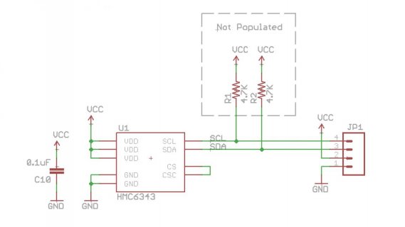

void readSensor()
// step 1: instruct sensor to read echoes
Wire.beginTransmission(compassAddress); // transmit to device
// the address specified in the datasheet is 66 (0x42)
// but i2c adressing uses the high 7 bits so it's 33
Wire.write(byte(0x50)); // Send a "Post Heading Data" (0x50) command to the HMC6343
Wire.endTransmission(); // stop transmitting
// step 2: wait for readings to happen
delay(2); // datasheet suggests at least 1 ms
// step 3: request reading from sensor
Wire.requestFrom(compassAddress, 6); // request 6 bytes from slave device #33
// step 4: receive reading from sensor
if (6 <= Wire.available()) // if six bytes were received
for (int i = 0; i<6; i++) {
responseBytes[i] = Wire.read();
heading = ((int)responseBytes[0]<<8) | ((int)responseBytes[1]); // heading MSB and LSB
tilt = (((int)responseBytes[2]<<8) | ((int)responseBytes[3])); // tilt MSB and LSB
roll = (((int)responseBytes[4]<<8) | ((int)responseBytes[5])); // roll MSB and LSB
