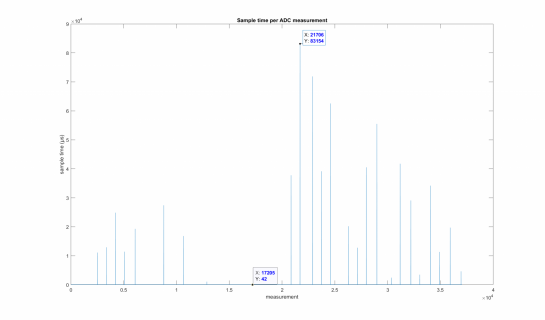

I am quite new to the Teensy environment and currently developing a little test program to verify my ideas. The program is supposed to do an ADC conversion from one pin every 40µs, and I want to save the reading for test purposes. I currently do not have a MicroSD card on hand so I am printing out the values of micros() and the ADC value so that I can analyse them in MATLAB later on. I have found out that my readings are not consistently spaced in an interval of 40µs, however it fluctuates up to 83ms. The 40µs sample rate is crucial for the reliable function of the project so I would be happy about some guidance on what I could do in order to increase reliablility. I have attached a plot of a sample measurement taken. I have gotten the data via CoolTerm, exported as .txt file and then used Matlab in order to create a plot from the data. I know this is not the most streamlined process but could this be the only reason my program does not deliver constant sample frequencies? Would this be better if saved onto an SD card?
I have already thought that the larger time span could come from a change in the signal, however multiple periods of the signal are displayed find around where the left data tip is set within the attached image. Further towards the end multiple periods are completely cut out or only displayed partly.

I'm not 100% sure how the TeensyTimer works, and I think your program is more complicated than it needs to be. Since you're just getting started, a few recommendations are (1) use IntervalTimer instead of TeensyTimer, (2) don't stop and start the timer, just let it run and do a sample every 40 us, (3) start with a simple analogRead() before you get into using the ADC library, (4) don't call Serial.print() from your ISR.

You absolutely need to use the ADC timer collection mode if you want consistent sampling intervals. In that mode the ADC collection is started by the hardware timer. The time at which the interrupt stores the data can vary if other interrupts of higher priority delay the ADC timer handler. That is not an issue as long as the interrupt handler can finish before the next ADC timer interrupt.
Matching the ADC sampling and conversion speeds to your desired 40 uSec interval may take some experimentation to get the best results.
