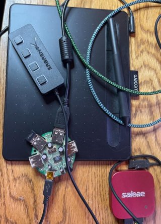

Teensy 4.1 USB-Host USB-Hub Mouse-Keyboard Problem
Sounds good.
But still might be nice to get the debug data I mentioned from the other thread. Yes, mostly a lot of the same information.
But would be good. To see for example are the HIDParsers grabbing the data, and if so, what are the values that change.
Probably also with debug information turned on in USBHost_t36.h
I do see some stuff with your mouse, that defines 16 buttons, but our mouse class only supports 8. But it should ignore the others. (Famous last word)
My guess is that this is a Wireless mouse with its own dongle. Where the dongle probably also supports a keyboard. And my guess is that it probably is claiming any keyboard object defined in a sketch, even though it may never see a real connected keyboard.
Not sure best way to handle this... Maybe simply define two keyboard objects, as well as a few extra HID parsers just to be safe. And deal with any keyboard input data from either one.
Probably why a few of the examples have two keyboard objects defined.
Prioritize the KeyboardController objects to HID devices without a Mouse Interface
So
KeyboardController kb1;
KeyboardController kb2;
Scenario: Mouse gets plugged in first, wait some times for another keyboard without Mouse Interface (e.g. 50ms), let Keyboard take kb1 and Mouse "Keyboard" the kb2.
In conclusion, I can only make one KeyboardController object and always know its the actual keyboard (without Mouse interface preferably).
Or maybe a MouseKeyboardController interface?

The Two devices did not work on the Sabrent hub which has been mentioned in this or another thread recently. It did work just fine using my older debug hub,
where I don't have the cover on any more as this is the one I typically use to capture USB traffic on the Saleae Logic Analyzer
Did you experience the ctrl bug or power save after going afk (e.g. 5min inactivity) at all?
