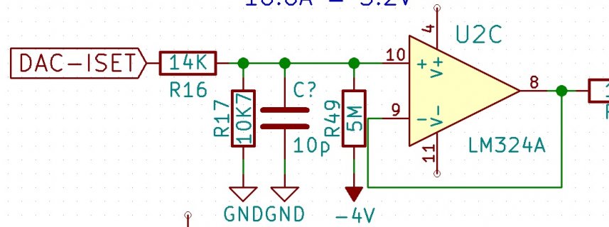

Think i'm going to change my dividers for the DACs and the current measurements from 14K and 10K7 to 14K7 and 10K2. It would drop my max current from 21.66A with a resolution of 1.0578715mA to a max current of 20.482A with a resolution of 1.0003383mA. I think that's the closest to 1ma per bit I can get without adding more resistors.

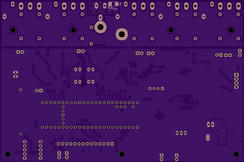

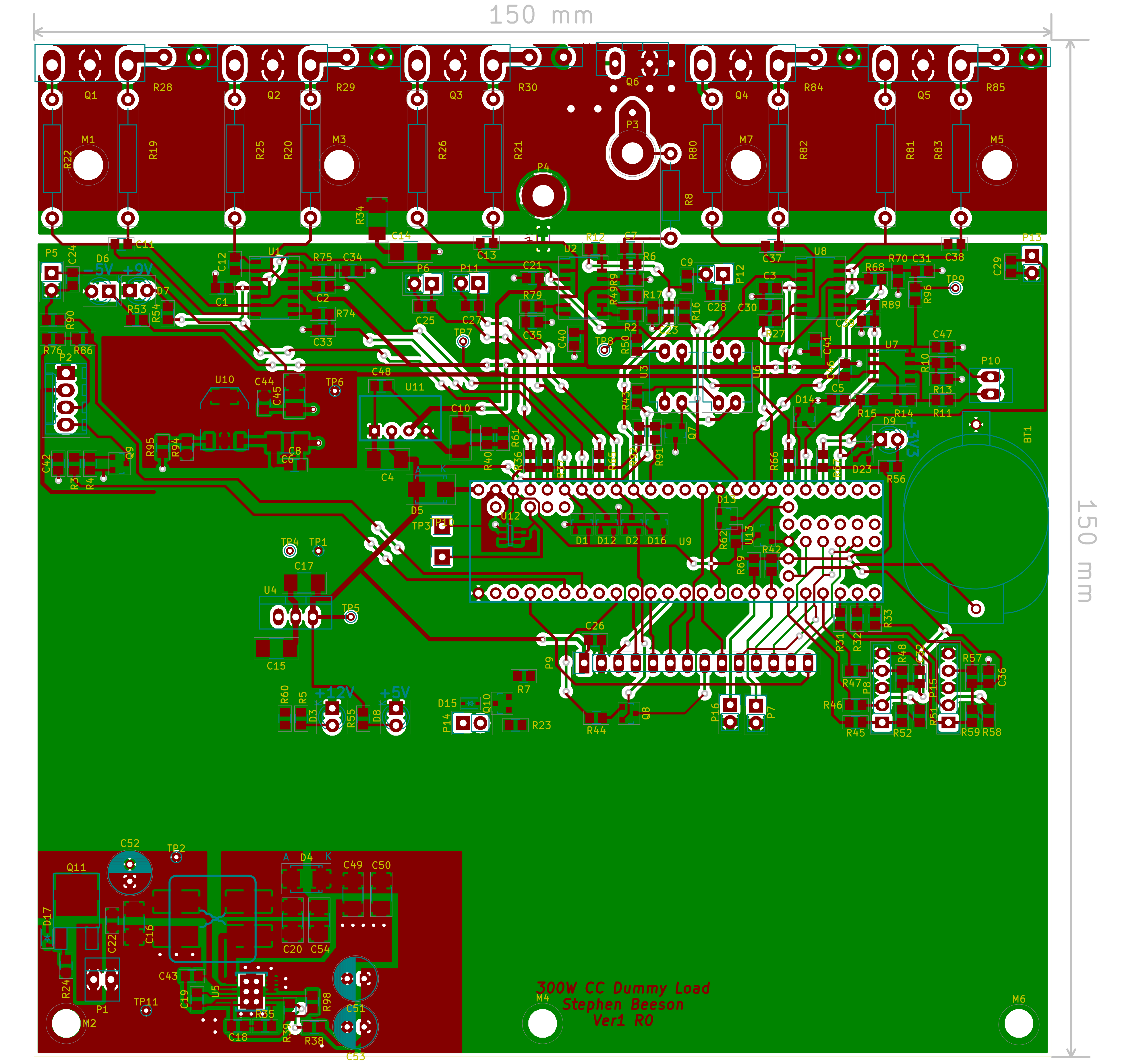

Started reworking the board. Think im going to go to a 150mm x 150mm board from 150x100. I want better spacing between some components and the addition of the Teensy 3.6 took almost a square inch of what little space I had to begin with away.

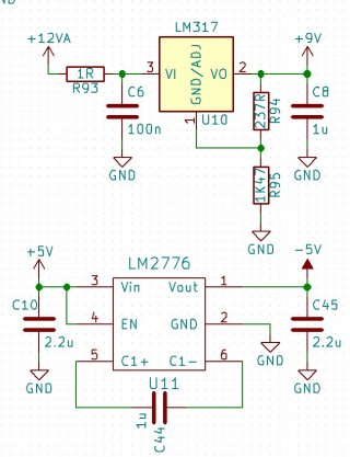

So I decided to remove the DC-DC iso supply I was using for +12/-12V for the Opamps.
Couple of reasons.
1. Cost, the Dc-Dc Iso supply was $6 vs about $3 for the Linear supply(LM317) and charge pump(LM2776), including caps and resistors.
2. Increased output capability. Both the LM317 and LM2776 can output more current then the DC-DC Iso supply's could ever produce.
3. We don't actually need +12v or -12V, we can get away with a much lower negative voltage since its there to ensure the OpAmp's can get to at least 0V on the gates. We also don't need +12V since the majority of Fet's we would use turn on much sooner and we are trying to drive them linearly so we should in theory never need more then 6-7V.

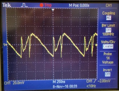

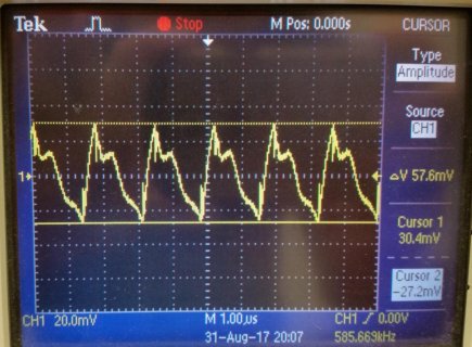

The thing is that the LM2776 produces a crazy amount of output ripple (>100mV for small currents). For this reason, I am not a big fan of it in combination with a linear voltage regulator (like the LM317), which has very low ripple.
I would rather use an LTC1550 which, although not being able to source as much current as the LM2776 and costs $2 instead of $1, can still go up to 50 mA (at a 6.5V VCC) and has ripple characteristics <=1mV. Since a lot of current is not needed for op-amp use, this may be a better solution if ripple characteristics are important (i.e., depending on the PSRR of the op-amps employed).
Looking at the example circuit for the LTC1550 I see why it has such low ripple. It only uses 0.1uF charge caps and it uses larger output caps, they dont jump out and say it but im sure its impedance is pretty high. Edit, its also a regulated charge pump vs unregulated. I would only be feeding 5V so I would be limited to 20mA. Not sure I want such a low amount of current. Driving 4 Op Amps and 5 fets.
I will look further, I had not noticed the high ripple at low loads on the LM2776, I will look at other options or adding extra filtering.

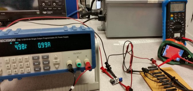

Think I will need to rethink the Sepic. Testing with minimum 4.5V input and 12.3V out @ 300mA seems to be the safe limit for my test setup. I attempted to raise the limit to 370mA(at 4.5 and 5V input) after letting it soak at 300mA for a while and it ran for about a minute before the Sepic shut itself down.
The inductor I chose was overrated by about 250% so I could see if I can find a bigger sepic IC that can do 2-3A. The LT1961 is only rated at 1.5A.
I need to get more of the parts together and measure the actual load needed to keep it all running. I was guessing at around 350mA, which is to close to the apparent limit of this design. The other factor is, what are the chances someone wants to run this with a 5v 2A USB Battery other then myself?:confused:

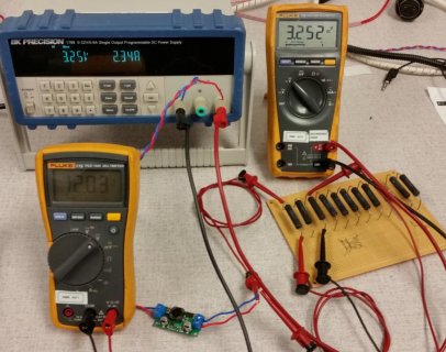

Did some measurements with a T3.1 DAC dis-morning(I will retest with a 3.6 when its done on another project). Found that it can pull a 20K resistor down to 10mV roughly, with about 20mV of noise. I added a 5Meg pull down to -4V and added a 10pF cap to reduce noise. The 5Meg pulls the 10mV signal when the DAC is set low to -3mV, allowing me to turn the current down in much finer steps at the low end, the upper limit was not affected much since I assume anything past 3.2V from the DAC is extra headroom(T3.1 DAC made it to roughly 3.29V).

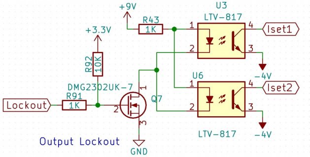

I also made changes to the Output lockout so that it would actually do what it is supposed to do, force the outputs off during startup or when the system is not enabled.

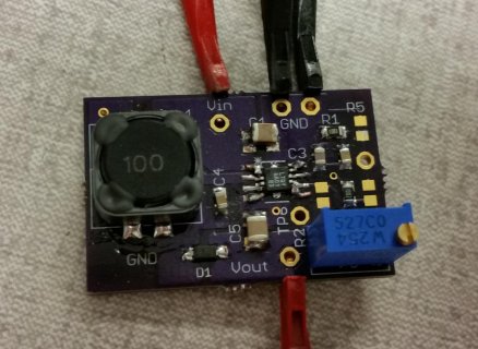

Still not sure if I should stick with the LT1961. I can either raise the minimum voltage meaning 5V input would not be feasible, find ways to reduce current draw, go with a different Sepic IC, or drop the idea of using a Sepic and use a different scheme.

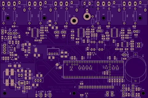

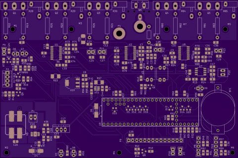

Had some free time so worked on the PCB, I still need to do testing of some of the circuits. But I have a pretty good idea of what it will look like now :)
Still have some cleanup to do but I think its a decent start, I need to order some parts in the next few days to test parts of the circuit(supplies) that I need to confirm before I commit to them, I should also have some ILI9341 Touch screens coming from PJRC in the next few days to test power requirements.

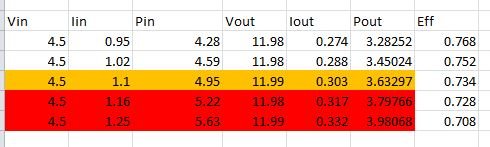

Performed a few more tests on the LT1961, it looks like going over 300mA@12V output with it would not be wise with a 4.5V input. The 2 bottom rows in red where unsustainable for more then a few minutes, it has been running happily for over an hour at 302mA but going over seems to rub it the wrong way and it heats up quickly and shuts down. Granted the PCB is only 1.26 square inches, I think pushing it harder would just cause issues.
I have been looking at 2 IC's from TI that would do the job, they are pin compatible with each other, they also have adjustable frequencies. The TPS61175PWPR and the TPS55340PWPR .
The 61175 is rated at 3A with a 18V max input and 38V max output. 5 cents more then the LT1961
The 55340 is rated at 5.25A with a 32V max input and 38V max output. $1.16 more then the LT1961
For the vast majority of people I think the 61175 would work, the 55340 would only be needed if you wanted 24V input capability.

I'm also looking at increasing the PCB size from 150x100mm to 150x150mm. I would like to space some items out a little more then they are and I have run out of room using the 150x100mm size.

WIP Cad Rendering (PCB holes are out of place, its an old IDF)
Still tinkering, mostly in Kicad/Autocad, I need to get going on the screen at some point. I came across Scullcom Hobby Electronics on Youtube and have been watching many of his videos. I'm currently looking at making a Millivolt meter based on Barbouri's take of Scullcom's design. And most likely a Voltage reference board.
