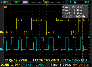

Hey all,
I'm running adafruit's tlc59711 library on a teensy 3.1: https://github.com/adafruit/Adafruit_TLC59711
teensyduino 1.22
arduino 1.06
(same problem occurs in teensyduino 1.18-rc1 with arduino 1.05)
This is a breadboard situation, but I have the tlc59711 powered separately and co-grounded with the teensy. I understand that breadboards are not ideal environments for high-speed data testing. That being said, the flicker is consistent as to being in the lower brightness levels whether ramping up or down. Signals look clean wherever I scope them. Experience and intuition tell me it is code timing.
I run a simple brightness loop (code below) that ramps from 0 to 3000 (of 65535) increments of 20 (i+=20)
I notice some random flickering in the lower brightness registers (probably in the hundreds) as it ramps up. If I run the loop all the way to 65535, the flickering is not apparent in the higher brightness values.
When I scope the clk signal I notice that the clock stays high for two cycles occasionally (see image). Is this normal? could it cause such a flicker? It seems to happen every 8 clock cycles.

I am thinking it might have something to do with the Software SPI bit banging timing?
I am using pins 7 and 8
I would use the hardware SPI pins, but those are reserved for the SD card.
Just for fun I moved clock and data to the Hardware SPI pins (11 and 13).
I am having the same flicker but now much faster!
Have either of you tried the TLC5940 as there seems to be a specific lib for that for the teensy. I am just trying to work out what chip to use for a POV.
Interestingly, I am unable to affect a change in the SPI speed by changing SPI.setClockDivider(SPI_CLOCK_DIV128);
Also unable to change mode: SPI.setDataMode(SPI_MODE3);
flicker potentially solved.
the adafruit breakout board has 5 input and output pins:
GND
VCC
V+
CI
DI
I mistakenly thought I could have the VCC in not connected. The data sheet for the tlc59711 states that, when run from 3.3 to 5 volts, the Vref (v+)pin should also be connected to VCC.
The data sheet also implies that it can be connected to ground with a 1uF cap.
anyhow, Thanks for the opportunity to publicly go through my own troubleshooting process.

So did this solve the issue ?
I finally fixed this for me. Wow did this take longer to figure out than I expected. It boiled down to a clock problem. Teensy was sending serial data too fast, and the Adafruit library has the lines below which are supposed to set the clock speed and other serial options but weren't actually doing anything.
SPI.setBitOrder(MSBFIRST);
SPI.setClockDivider(SPI_CLOCK_DIV8);
SPI.setDataMode(SPI_MODE0);
The library for the TLC59711 references old SPI code. I think the clock settings, the MSB settings, and the phase settings were basically being ignored. I updated my TLC library to take into account the new transactional SPI code as show on this page: https://www.pjrc.com/teensy/td_libs_SPI.html.
And set my settings to: SPISettings SPI_SETTINGS(1000000, MSBFIRST, SPI_MODE0);
I also had to put "SPI.beginTransaction(SPI_SETTINGS)" at the beginning of the Adafruit_TLC59711::write() method, and put a matching "SPI.endTransaction()" at the end of the method. See below.
No more flickering or glitchy fades.
Best -- Andrew
