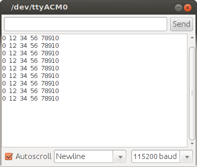

About Serial.printf.I get the following error:
/home/user123/arduino-1.0.5/hardware/tools/arm-none-eabi/bin/../lib/gcc/arm-none-eabi/4.7.2/../../../../arm-none-eabi/bin/ld: section .progmem.data loaded at [000000000000a15c,000000000000a16d] overlaps section .data loaded at [000000000000a15c,000000000000a78b]
collect2: error: ld returned 1 exit status
Sorry. I thought it was a known issue or something like that:
Serial.printf("%d %d %d %d %u\r\n",header.from_node,payload.id,payload.command,payload.pin,payload.data);
payload and header are structs like:
struct payload_t
byte id;
byte command; //read, write, set digital, set analog
byte pin; //pin number
unsigned int data;
removing that line makes the rest of the code work. It's long, and closed source.
If you want me to investigate, you must post a complete program that I can copy into Arduino to reproduce the problem. I don't need to see your entire proprietary application, but I do need you to copy just the part that crashes into a small but complete program that reproduces the problem.
Here is a perfect example of why I insist people post a complete program that is reproduces a problem!
I copied the struct definition and printf line into a small test program. I filled in the missing parts, substituting zero for the first variable since I have no idea what "header.from_node" is. Since it's referenced by "%d", I assumed at integer. (if this isn't actually an integer, it very well may be the cause of the problems you're seeing)
Here is the code I tested:
struct payload_t
  byte id;
  unsigned int data;
payload_t test;
  test.id = 12;
  test.command = 34;
  test.pin = 56;
  test.data = 78910;
    0, test.id, test.command, test.pin, test.data);
As you can see in this screenshot, I was not able to reproduce the problem.
Normally when people post these bug reports without a complete program, I don't do this work to turn them into a complete program for testing. It pretty much always ends up this way.
I'm not denying there may indeed be a bug. I really do want to investigate and fix any bugs. But until you post a complete program that reproduces the problem, what am I supposed to do?
