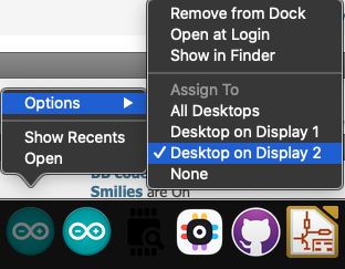

I can confirm it does indeed crash on an external monitor, works fine on the main monitor, but crashes when moved to the external monitor on MacOS Catalina 10.15.5 Beta 3 still.
Arduino 1.8.11 crashes on the external monitor as well when scrolling or resizing, 1.8.10 doesn't crash when scrolling or resizing, but does crash on both monitors when clicking the scroll bar.
Edit: The scroll bar problem seems to exist on 1.8.10-1.8.12 on MacOS 10.15.5 Beta only.
Also of note, if Arduino is assigned to the second display and opened then it won't crash on the second display, but it will then crash on the main display when dragged to it.
