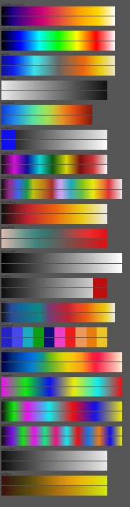

My though was then to generate them from the base colors instead
then they would not take up so much space and could be generated at runtime
to fit any display size.
This lead to that I found code from FastLED (line:106)
https://github.com/FastLED/FastLED/blob/master/src/colorutils.cpp
also used the CRGB structure (or based my own upon it) from FastLED as it's easier to use.
Did beforehand do a own version of (fill_gradient_RGB),
but do now use the FastLED version as it generates smoother results
First I did try the code out in JavaScript (as it's very similar the conversion was no problem)
https://github.com/manicken/ThermographicCamera/tree/main/PaletteEditor
(not really a Palette Editor yet)
Where I also printed the color palettes from "DIY-Thermocam"
to see how they really looked like
(using 2d context on a canvas + createImageData + putImageData)
could then save these generated palettes as PNG:s
so I could use paint to extract the base colors
these was then put into the JavaScript program
so I could print both the "original" + the generated version
and the be able to finetune the percent's used to determine
how the generated palette would look like.
here is a example how two palettes could look like (JavaScript)
the same but in c++ struct
here they need to be all in one array,
and is using a another struct array to store the sizes and names
Here is the results in from the JavaScript program

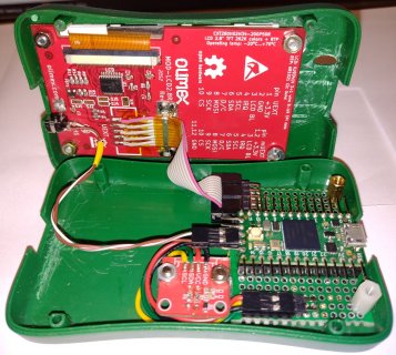

But I did also wanted to have this size "standalone"
so I bough a Olimex mod-lcd2.8rtp display (320x240 2.8" ILI9341+AR1021)
(it also have touch so I can make a settings screen in the future)
changing the color palette with two buttons at the moment
(in the current box they are no implemented yet, did exist on the breadboard)

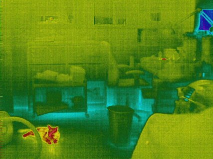

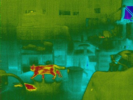

I have upgraded the "Tool" to receive and show images in a 'Node'
It uses the "Web Serial API" to receive the raw images in the "Roboremo-format".
This makes the "Remote Control (streaming)"-development faster
as otherwise it needs to be disconnected from my computer to the mobile.
here is a video showing how it looks like

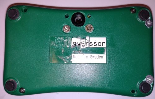

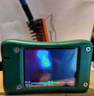

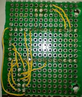

here is some pictures
Is built into a recycled box from old test-equipment for old mobiles (sony ericsson)

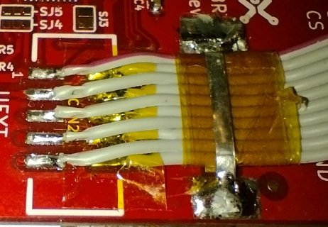

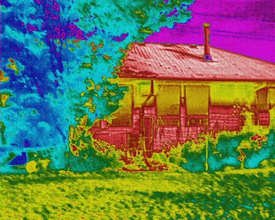

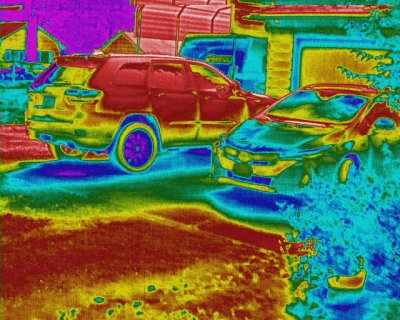

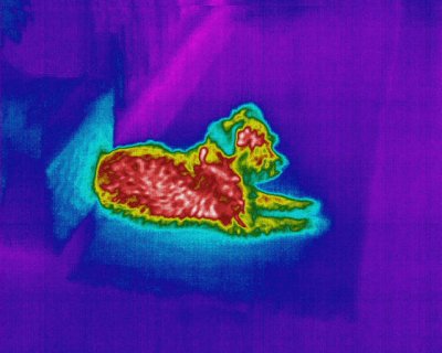

Here the wires are soldered direct onto the display
this makes some extra space that can be used for a future built in Li-Ion battery + TP4056 charger
currently powered by a external powerbank which is bulky
thermal camera "local" (standalone mode)
https://www.youtube.com/watch?v=3VbFxfoDFB8

But then I was not really happy with the current color palette, think I found it here
https://github.com/adafruit/Adafrui...l_cam_interpolate/thermal_cam_interpolate.ino
and wanted to try some other
this was a fairly hard task as there is not really anywhere to find any (except for very blurry images)
but found finally this other project
https://github.com/maxritter/DIY-Thermocam
that did have 18 variants
but as they do take a lot of space (which makes the reprogramming slower)
also they do have different sizes and do not fit into the screen size
so each color palette would had to be remade to fit my particular screen size
Now I did think that the screen was to small 1.3"
And because the RoboRemo-app that I'm using for different projects
can receive and show Images in a so called Image-object
and do work together with USB OTG CDC.
First I did think it would be slow, but wanted to try it anyway
but after I did try it the first time it worked perfect
at least receiving 224x168(24bit) images
then I also put in some buttons to direct-select the current color palette
+ one image to show the current color palette
(updated only when the color palette is changed)
+ three textboxes to show the temperatures
here is the result
This bigger display have a bigger resolution so now the framerate is down to ~5fps
(which is maybe not a big issue)

The resulted images now however is still a bit noisy
and did try Gaussian Interpolation from
http://blog.dzl.dk/2019/06/08/compact-gaussian-interpolation-for-small-displays/
+ my own tryout that work like this:
1. sensor 32x24 pixels "Gaussian interpolation" to 64x48
2. Bicubic interpolation from 64x48 to 160x120
3. Bicubic interpolation from 160x120 to 32x24 (maybe unnecessary to run Bicubic here, but easiest at the moment)
4. Bicubic interpolation from 32x24 to 288x208
that above decrease the noise but I did was still not really happy with it
The current version now uses a average method,
which uses a kind of circular buffer to store the latest read values
(up to 32 hardcoded, can be changed by a serial command)
this makes the update more smooth (faded)
