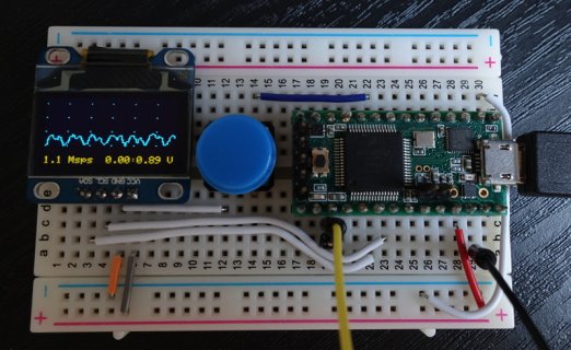

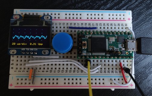

I realize this is just a toy, but it's still fun to play with and pretty useful when I need to see whether the pins are signaling or just floating around. A picture is worth a thousand words:
There's an automatic voltmeter mode that kicks in when the input is relatively stable and I'd be staring at a flat line. There's a zero trigger and a sane ms/div value displayed (the grid changes to accomodate). I used the SSD1306 OLED screen. Code is here: https://github.com/laurb9/tiny_scope
This works on both Arduino UNO and Teensy 3.1. I'm using the stock analogRead() for now without any optimizations, but I do change the ADC parameters to get different sampling speeds. In the tiny_scope.ino, there is an ADC_MODE value that can be changed from 0 (slowest) to 5 (fastest). I can reach sampling rates from 10Ksps to about 300K on Teensy. I should probably add a button for that.
One thing I did notice though, with Arduino 1.0.6 code size is 26K and fastest sampling speed is about 330Ksps. Same code with Arduino 1.6 (beta) is 45K and speed drops to about 250K. Still a lot faster than what I get on the UNO.
This is the assembled project:
A pen sized analysis device, almost. One step closer to a sonic screwdriver... Now, just add a super inductive magic magneto unlocker thinga majig and you are set.

Thank you everybody. Next steps are to try and see if I can read the ADC any faster (I know on Arduino there is a lot of setup stuff in readAnalog() that only needs done once per loop), add a button to change sampling speed, and try and integrate an FFT lib to display frequency. Maybe auto select the correct time base range although that's not always a good idea.

update
(update) using the pedvide ADC library, I was able to get up to 1.2Msps on the Teensy 3.1 (I think the LC also gets pretty close as well). At that speed it needs a strong input signal to get an accurate waveform, but it's nice to have nevertheless.
https://github.com/laurb9/tiny_scope/releases
(the older Arduino branch should work on most other boards, but at reduced speed)
