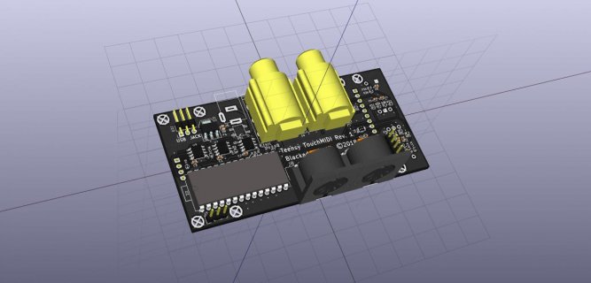

To keep the PCB cost reasonable I had to stay inside the 10cm x 5cm form factor. As a result I could fit 2 rotary encoders and and two TS jacks in addition to the 2 MIDI DIN jacks.
Here's the schematic.
and a couple 3D renderings of the board (not all components have 3D models). The "empty" side will mostly be covered by the touchscreen with the two encoders on the left.

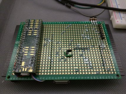

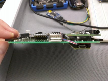

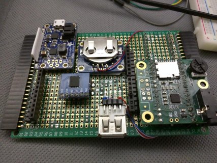

This sounds like a great idea. I was thinking of making something along the same lines but more of a UI for making music. Like a much simpler version of sunvox. I've currently got a perf board version of a teensy 3.6, audio shield, serial flash and a Gameduino 3. The gameduino has the FT810 GPU and can handle all the UI drawing which leaves more cycles and ram for audio processing on the Teensy. Here's some photos, without the gameduino mounted.
I need to get around to learning how to make a PCB.
It would be nice to have a slimmer profile.

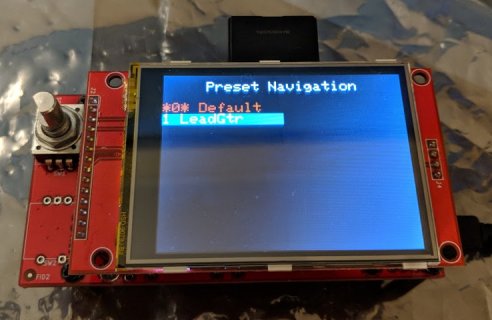

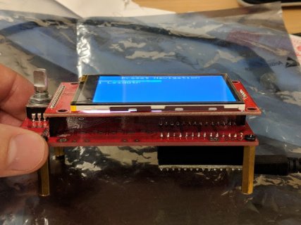

Finally getting back to this project while I wait for my next production batch of TGA Pro audio shields to come in.
I've mostly been writing platform code for the MIDI controller. So far I have:
- setup a Controls class for managing the touch interface, rotary knobs, and switches
- create a Preset class for handilng the name and a variable number of named MIDI controls.
- calibrating the touch screen and storing data on the FLASH card
- add JSON format processing for storing presets on FLASH
- loading presets from the FLASH card
- a basic navigation screen to move between presets.
Still lots more to do! The project is on Github here
