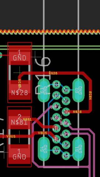

Hi everyone,
I'm planning to use this connector for a project with the Teensy4: https://www.mouser.sg/ProductDetail/Molex/216989-0001?qs=DRkmTr78QARfehpd11NNIg==
I have some questions on routing the PCB trace on both the A and B side. I have first routed it to the A side and made sure that the trace lengths are the same. But how should I go about routing it to the B side so that the USB C connector can be flipped? It's not possible to do a trace between the pins. If I do it like below, then would there be the adverse effect of having different trace lengths for the high speed signals?
Is there a better way to route the signal?
The D+ and D- traces are in purple/pink
