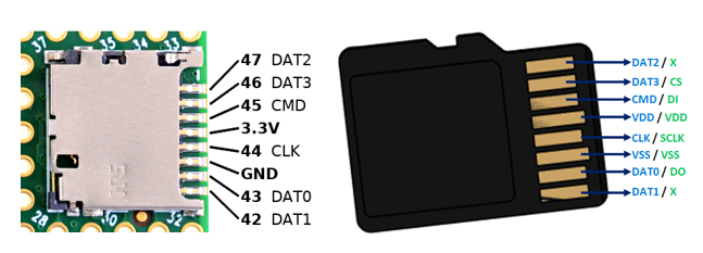

Good evening friends!
You confirm that the CS pin of the SD card socket onboard on the Teensy 4.1 is the number 46?
Pin 46 is DAT3. It is not CS.
All SD cards have 2 protocols, either a higher performance native mode where 5 pins are used for data (CMD, DAT0, DAT1, DAT2, DAT3), or a lower performance SPI mode where 2 pins are used for data (MOSI, MISO).
Teensy 4.1's SD socket always accesses your SD card with the native protocol. So pin 46 is always used as DAT3. It is never used as CS, because the slower SPI protocol is never used when the SD card is in the built in socket. It would be technically correct to say the pin on the SD card is either DAT3 or CS. But the mating pin on the Teensy 4.1 SD socket is only DAT3.
You can use SPI protocol when the SD card connects to SPI pins, like with the audio shield.
