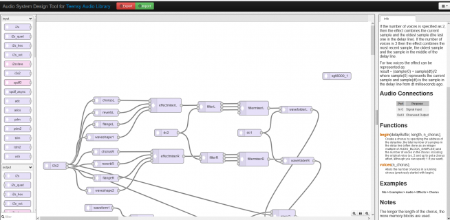

Hello together,
I am a newbee in this Forum. I use the Teensy Audio Library (Windows 10).
But I didn't find the example in the Audio Tools, like Chorus in the bottom right corner... Maybe someone can tell me where the examples are hidden...
Thanks in advance
Thomas E. from Germany
In Arduino IDE, first make sure you have Teensy selected either from the drop-down list in the toolbar or from Tools > Board menu. The rest of Arduino's menus update depending on the selected board.
Then look for the examples in File > Examples > Audio.
