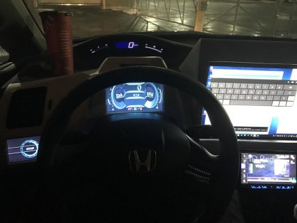

my guages were done via photoshop animation frames, you can use other stuff like imagemagic or whatever
the new release of Workshop supports smart objects, which create multi-level graphics and frames for you in a given widget space similar to how overlapping objects are, and can create animations for you with them.
the 4.3" is push-to-start screen, it loads a animated civic logo on screen power up, followed by a spinning activated START/STOP button, clicking on options gives access to the HVAC climate controls which can be seen in my other videos, instead of leds, i just created animated HVAC buttons that glow when activated, even have live CANBUS traffic of BCM, HSCAN, and ECU (switchable) directly on the gauge screen via another form
heres a sample i took in my setup
https://www.youtube.com/watch?v=OYf7b_v5GDE&feature=youtu.be
