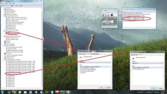

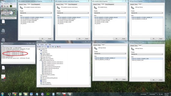

Here is a screenshot showing the verbose log from the Teensy Loader, as well as my device manager HID devices, and hardware IDS property dialogue box for each HID device.
Is the Teensy Loader looking for the wrong device? My device manager lists 5 devices that all have the same hardware IDS info that verbose lists, namely:
vid:046D
pid:C31C
ver:6400
I have determined that the item matching vid:046D pid:c31c ver:6400 is my keyboard, as shown in the next screenshot:
According to this support page, the HalfKay device info should be:
vid:16C0
pid:0478
I certainly don't have any HID devices or USB controller devices that match those parameters!
Why is the Teensy Loader trying to communicate with my keyboard instead of the Teensy?
