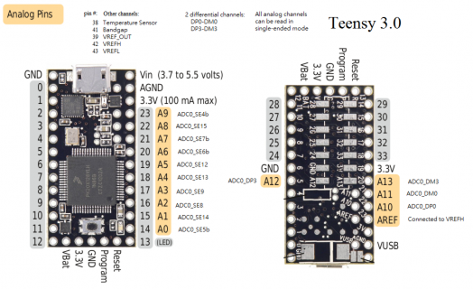

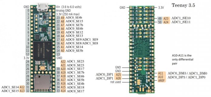

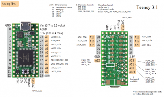

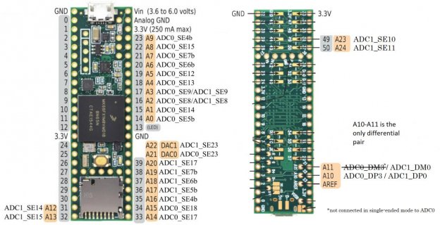

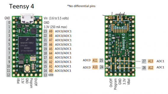

Pins
All analog pins can be measured, but not by both ADCs. The following images show which ADC can access each pin.
If the text next to the pin number says ADC0_SE## then it can be measured by ADC0, if it says ADC1_SE## by ADC1. Some pins can be measured by both.
Teensy 3.0:
Teensy 3.1/3.2:
Teensy 3.5:
Teensy 3.6:
Teensy 4:

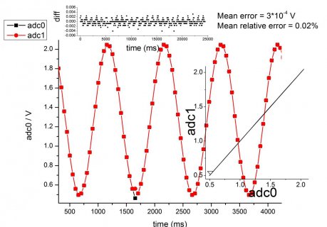

Synchronous measurements
It will set up both ADCs and measure pin1 with ADC0 and pin2 with ADC1. The result is stored in the struct ADC::Sync_result, with members .result_adc0 and .result_adc1 so that you can get both. ADC0 has to be able to access pin1 (same for pin2 and ADC1), to find out see in the image that next to the pin number is written ADC0_xxxx or ADC1_xxx (or both).
I've made a simple test with a wavefunction generator measuring a sine wave of 1 Hz and 2 V amplitude with both ADCs at the same time.
I've measured it synchronously in the loop(){} with a delay of 50ms (so 20Hz sampling), the results are here:
In red and black are the measurements on each pin, as you see, the difference is very small, so the system seems to work.

Pins
Teensy 3.0:
Teensy 3.1/3.2:
Teensy 3.5:
Teensy 3.6:
Teensy 4:
ADC::Sync_result result = adc->analogSyncRead(pin1, pin2);

For Teensy 4 the only extra source is VREFSH, which is connected to VDD.
