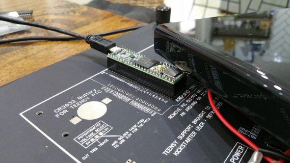

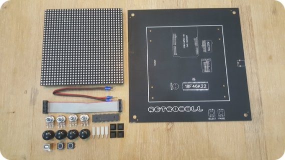

I and some other Teensy users saw a PIC based Kickstarter project that had a PCB footprint for UNO/Mega - and we asked about Teensy support. I hadn't yet backed so in reply to a message I got an ALPHA board from Australia to wire up - complete with smoked display cover that hides the white LED body and saves retinas seeing it up close.

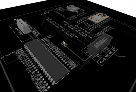

I found a fork of the Adafruit RGBmatrixPanel.h that supports Teensy 3.x's and as noted in the GitHub ReadMe shifted the Analogs used so the Teensy can use all four POTS where the UNO can only use two. So when I had working wiring I sent an XLS of the pin list to Brad and he marked up his PCB - then I asked for RTC battery and a second row of headers to allow using more of the Teensy and a way to set the pots to 3.3V to make it safe and expandable for all of the Teensy 3.x family. I found it not to work on T_LC with the pin signals as presented to the display - the color control slips to yellow?

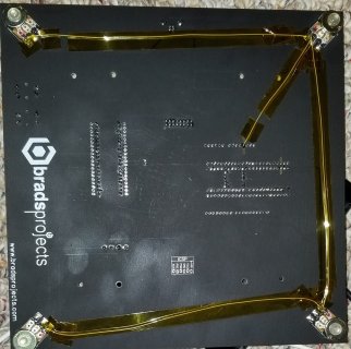

Here's the result he just sent off to have a PCB made:

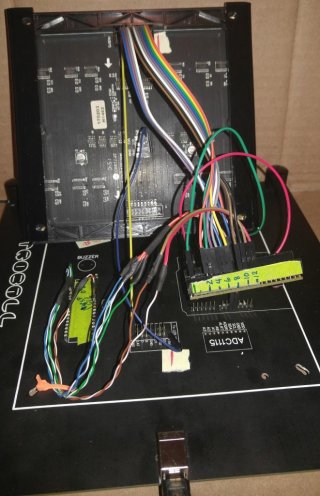

Which will be a bit neater than this:
I tested on T_3.1, 3.5 and 3.6 from 8 MHz to Overclock and it shows no signs of trouble - of course not surprisingly at 8 MHz the POT updates net about 1 second
This uses the AdaFruit method of a timer to manually push out the batches of bits - not DMA - though at full speed Teensy will have plenty of CPU left. It uses 13 pins - plus 2 switches and 4 pots on the base T_3 footprint.
I had to cut the VIN<>VUSB of course as the Display is externally powered ( 2 A for 32x32 panel all white ). One thing I saw was when I powered the display from a powered USB HUB it worked but it was using the Teensy Programming USB GND for a return path and this would require pushing the button to program? I could tell something was amiss because my USB Charge Doctor power meter would go from 1.5 A to 0.9 A when I plugged in to program - and at the same time the display would brighten when the cable touched the USB connector. If some EE type has more info it might help others diagnose similar issues - when USB programming requires a button push is it a GND problem?
