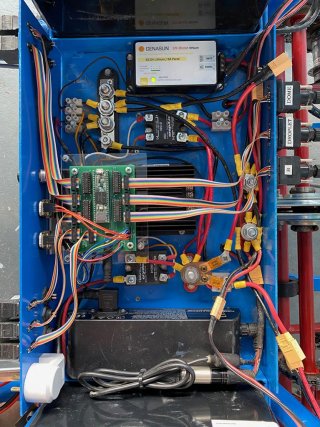

We have been building art cars (mutant vehicles) for Burning Man for many years. Our current one is based on a solar electrified Worksman side-by-side tricycle. For night driving it is illuminated by 22 pairs of NeoPixel (WS2812) strips for a total of ~6400 RGB LEDs. The strips are in pairs because half of them are always on the other side.
Anyway, many of the dozens of light patterns are animated and there was a strong desire for the animation to be as smooth as possible which required a high frame rate. The lights are controlled by a Teensy 3.6 running at 256 MHz that drives all 22 signal lines in parallel through some 74HCT245s at the maximum clock rate for the neoPixels. We can easily achieve well over a 200 Hz frame rate.
The code presented in this post is an illustration of how that works. Here we show a 32 channel example, which, btw., also runs at the maximum NeoPixel clock rate of ~1MHz. Total output rate is ~1.3 million RGB pixels per second.
The serialization of the color bits is done in the TRANSPOSE macros using the BFI instruction for the ARM and a word is sent directly to the ports on the chip. The NeoPixel documentation has separate timing rules for sending a zero and a one. We just turn on the line, wait 200 ns, send out the data bit which either turns it off (a zero) or leaves it high (a one), wait ~400 ns and send out a zero which turns off the one or leaves it low, then wait ~400 ns for the next bit. The serialization fits in nicely during the wait for the next bit.
Serialization of 32 channels is accomplished in the ~400ns of interbit time. Our 22 channel version has NOPs to make the timing work out. Adding more channels beyond 32 would cost about 3-1/2 cycles each.

Control board with Teensy 3.6 and HCT245s, plus battery chargers and relays.
