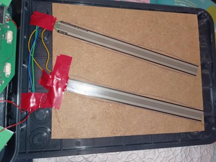

lately i wanted to have more expression and control over the sound, and also wanted to use hardware synths exclusively. so i attached some FSR strips to the bottom of the axis case, and searched for a solution to integrate those in the MIDI stream and remap the axis before it hits my synths.

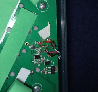

upon looking at the PCB of the axis-49 i realised that it has only two microcontrollers on board, the DSP and a PIC to handle USB-MIDI.

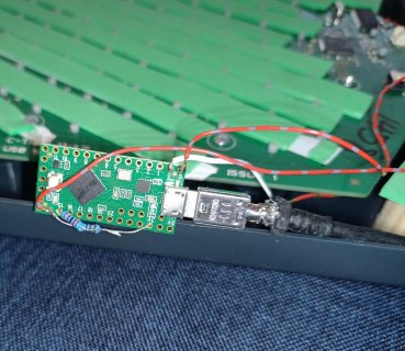

since i knew the axis 49 has a bigger brother with din-midi output (the axis64) and the source code of the axis-49 firmware is luckily available, i quickly found out the DSP-->PIC communication was happening over a serial line, and was essentially MIDI already. i hooked up my oscilloscope to Pin18 of the PIC (the Serial RX Pin) and sure enough i got some nice activity when hitting keys on the axis. next i soldered a cable to PIN 18 (see jpeg above) and connected that to the teensy-LC RX pin and wrote a little serial-to usb MIDI converter Sketch. i powered it on, and nothing happened...
upon further investigation i found out, that while they use MIDI, they don't use the MIDI Baudrate, instead they run the communication at 57600 baud. changed that in the teensy sketch, and boom, it worked!! attached the fsr strips to an analog input and also added a softpot for pitchbend, and it all worked really well.
for more convenience, i cut the two traces from the PIC to d+ and d- on the usb connector of the axis and connected the teensy lc 5v GND d+ and d- to the axis port. that way it is all contained in the original case... i also changed the MIDI name of the Teensy to Axis-49 WH, cool!
