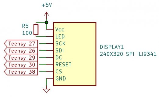

in my application I use a T.41 + Audio Board Rev.D + W25Q512JV (flash memory) + n.2 ESP-PSRAM64H.
The TFT display uses SPI1 pins (instead of SPI0, because there where issues on SPI0):
and everything works perfecly.
