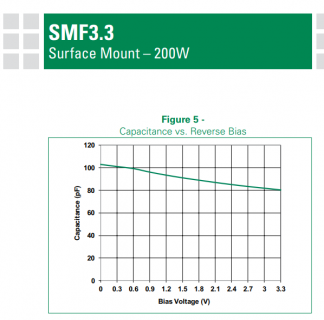

      sicco replied to the thread SPI data via DMA corrupt.
      Maybe capacitance from the zener diodes. Note that the zeners are 3.3V and the logic high voltage level is also 3.3V, so already in normal operation these zeners start zenering already - with parasitic capacitance going sky-high. But you...
