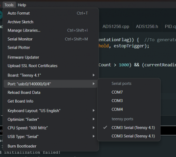

I want to have 2 Teensy boards together in one of my application and today when I tried to connect and program a new Teensy board with 1 Teensy 4.1 already connected to the USB port, the new board also got assigned the same COM port.
Rebooting the PC, uninstalling-reinstalling the driver didn't help in solving the issue. Requesting the support in solving this. Please check the image attached.

Thank you for the reply.
teensy_ports -L command gave the following result:
usb:0/140000/0/4 COM3 (Teensy 4.1) Serial
usb:0/140000/0/1 COM3 (Teensy 4.1) Serial
On running teensy_ports.exe, the following details are shown:
"address": "usb:0/140000/0/4",
"online": true,
"label": "COM3 (Teensy 4.1) Serial",
"vid": "16C0",
"pid": "0483",
"iserial": "1604758",
"boardName": "Teensy 4.1",
"protocol": "Teensy"
"address": "usb:0/140000/0/1",
"online": true,
"vid": "16C0",
"pid": "0483",
"iserial": "1663720",
This is very unusual. Something must have gone very wrong with Windows. You can reassign the COM port number, but whether it fully resolves the problem is difficult to know, because I don't understand why Windows made this mistake.
To change the COM port, use Windows Device Manager. In taskbar, search "device manager". Then under "Ports (COM & LPT)" click the device you want to change. Then click "Port Settings" tab, and then click "Advanced" button. You should see this dialog:
To change the COM port, just click the drop-down list and select a different COM port number. Do not use COM1 or COM2, as those never work for USB. It must be COM3 or higher.
Hopefully this fully solves the problem? Please let us know? And if you gain any insight into why Windows made this mistake, please let us know. It is indeed very unusual and should not normally happen.

Hello Paul,
Thank you for the quick reply. It was indeed strange from Windows. I was able to change the COM port with your suggestion. Thank you
