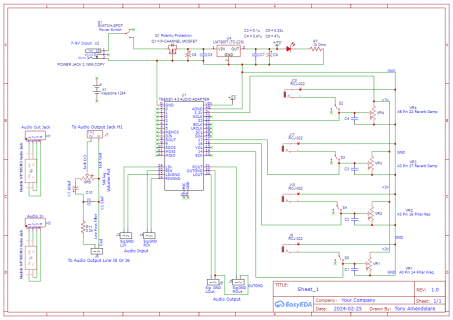

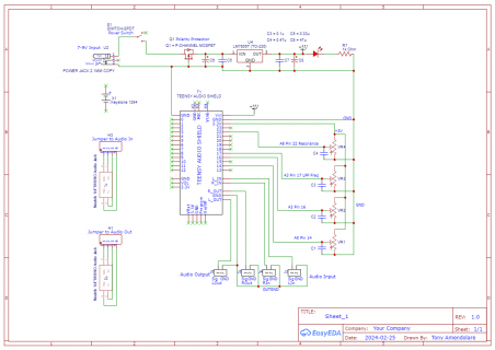

Hello,
I am making a simple pcb for the Teensy Audio Shield 4.x Rev. D. I am using EasyEDA and a "footprint" I found for the shield. I just have a few pots and connections for audio in and out. (And also have a 5V regulated power supply).
New to using the Teensy/Shield. Does that "footprint" look correct? Any advice, help would be sincerely appreciated.
TonyAme
Connect the 4 pots to 3.3V, not to 5V. And connect the 4 capacitors between the signal and GND, not between signal and 5V.
Also on the 2 output connectors, J6 and J5 need to have GND to OUTGND on the audio shield. Looks like their GND pins are connected only to each other but not the audio shield GND.
Thanks for catching the reversed power/ground I had for the pots. Here is an updated schem.
Any suggestions/ comments welcomed.
Thanks,
TonyAme
The pots have ground and supply switched too I think, caps normally to ground.
Yes, I've updated my schem. Thanks for checking it over, I appreciate it.
I noticed that on the Audio Shield diagram REV D (for Teensy 4.0), that all of the audio input and output (line level) gnd's are connected together?
I've also updated my shem, see attached image. (I might still be "missing the boat" on the audio ground, please let me know).
Sincere Thanks.

Updated schematic for Teensy Audio board. If anyone could use this schematic for their own project, please feel free. (Also, would be great if anyone could point out any potential problems, or make suggestions).
I have RCA jacks, which will connect CdS photo-resistive sensors to the analog input ports, adding their resistive values to that of the pots. CdS sensors are activated via spdt switches.
Thanks again,
TonyAme
I don't understand the purpose of J9,J10,J11,J12 on this new schematic. But if you intend to plug external cables with lengthy wires into those jacks, you might consider whether connecting Teensy's I/O pins directly might be asking for trouble? Teensy can be easily damaged if any pin is driven hard (relatively low impedance) below GND or above 3.3V. Normally for connecting external cables that might get a variety of possible (wrong) things plugged in, some form of protection circuitry is usually desired.
The J9-J12 will be used for plugging in a photocell sensor that is wired to plug into female RCA jack. I do this kind of thing with Arduino Nano's, but never before with a Teensy. It adds a fun, unexpected element to the sound. Yup, I should find out what kind of protection circuit to add to the analog input. Thanks for pointing that out. (Any ideas or suggestions for the protective circuit would be welcomed).
Sincere Thanks,
TonyAme
