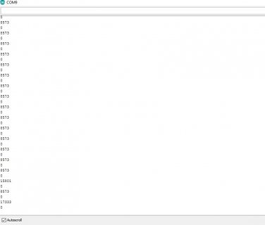

Thank you very much for your quick response. I've tried your suggestion, but I'm a little confused by the output. The 'data' is printing samples of of the 128 array and they way i had it set up is that i'm sampling from microphone and printing all 128 sample in a 'for' loop. However, all of the printed samples are the same, and there are bunch of zeros ... Not sure what i'm doing wrong. If queue is filled with sample from microphone should they be somewhat random? Another question, does each sample represent 16 bit voltage from ADC from -1/+1 volts? Little confused on this... Any help/input is greatly appreciated. Thank you!
my screen capture of serial monitor:
my code:

My apologies. Thank you for posting reply. I've read over the Recorder example but that is of no help to me because it writes the data to SD card and plays the .wav. I just want the raw data samples from the buffer and I cant seem to get that.
Yes, it writes the Data. So, it gets them :)
It shows how to access the data, the usage of "MicMem".begin(); MicMem.end(); MicMem.readBuffer();" and much more. Try to "read" it.

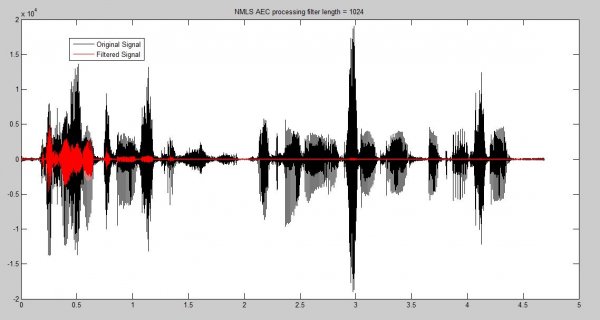

Hello All,
So i've been able to make little progress on this project. To test the echo cancellation algorithm i've chosen to use simple NLMS algorithm. the way i'm testing this algorithm is i'm running the set up on one teensy and sending mic signal to both inputs of NLMS algorithm, far side and near side. The code works, but the problem i'm having is that I'm not sure how to make it faster, or keep up with teensy's sampling. I've posted code bellow.
Basically, because of 'for' loops the NLMS algorithm takes long to process one block of audio samples. 1 block is about 2.9 ms of time, but running code in real time takes longer. As a result, the output to speaker is choppy because NLMS code has to complete before audio starts sampling again. I'm looking for some advice on how to implement it smarter, or mayby i'm approaching this wrong way. Any advice would be greatly appreciated.

I believe the DSP extensions can make a massive speed increase for these 2 loops:
                for (int j = gg; j > 0; j -= 1){
                        yhat += (x[j+h]*pw[gg-j])/32768;
                        xtdl += x[j+h]*x[j+h];
The yhat variable will become int64_t (yes, that will actually be faster) with the 15 bit shift done only once after the loop.
                for(int j = 0; j<gg;j+=1){
                        pw[j] = pw[j] + (x[gg-j+h]*mu0*error[h])/131072;
The DSP extensions can be used with 32 bit data packing and the successive memory fetch optimization and partial loop rolling, which gets the data from the arrays much faster, and then does the math much faster. The chip has 2 operation SIMD which can be used in this case. The details are complicated... so it's important to get this code correct before making the difficult conversion to the DSP extensions. It will make a tremendous speed increase!
Let me know when this is on github with a MIT license, and I'll work on the speedup part.

wav2sketch is a command line program, so you must run it in a terminal (Mac, Linux) or command prompt (Windows). First, type "cd" commands to change to the directory where you have WAV files for sound clips. The WAV files must be 44, 22 or 11 kHz. Then type either "wav2sketch" or "wav2sketch -16". The first uses ulaw compression. Adding "-16" preserves the 16 bit data, but at the cost of larger memory usage. It will read all the WAV files in the current directory and convert them all the .c and .h files.
"gg" is 128 (minimum), there are two loops of it which means 2*128 =256 loops per sample, 128*256 per block(=32768). Is there a way to save some iterations ?
'gg' is the index location of the last block in the 'Mic' and 'x' array. so lets say we have a filter length of 128, this means that 'Mic' and 'x' need to be length of 256 and gg = 128. If filter length is 1024, then gg = 1024 and 'Mic' will have to be length of 1024+128. The outer 'for' loop, in NLMS, will always calculate 1 block of data, which is an array of 128. This block of data is calculated using past samples: length of past sample has to be same as length of filter. That block of data will be stored in error array and sent out to speaker, in my case, or to the far side speaker (the speaker of the other teensy). error array will always be lenth of 128, however length of filter will change, which will change length of 'Mic' and 'x' array. So, I don't think that there is away of avoiding iterations. what i have in NLMS is the minimum that would be needed to calculate error array. Now, as far as I understand some optimizations can be done to make this more efficient in DSP.
At 96 MHz, we get 100% CPU usage at approx 2000 cycles per sample. So ultimately that's going to impose a limit on how many iteration are possible.
I'm going to make a first attempt at using the DSP extensions, so we can see how many cycles/iteration are really needed...
perhaps unrolling the outer (variable h) loop.. by two or four
..could help, and even if it is only to use combined loads and stores (which are more efficiant)
for example

Would this algorithm still work well enough if the w[] array were half the size and each filter tap applied to 2 audio samples?
Edit: some good recorded test cases would really help for collaborating....
Hi Frank,
Thank you for suggestion. I'm not sure though that that will work for AEC part. It might be efficient as far as saving iterations, but not for the algorithm. In the code
