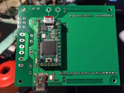

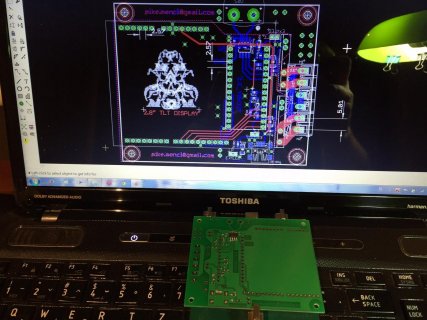

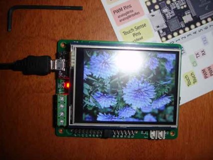

thanks for posting this! helped me get the 2.8" working since i had the same problems, along with sumoboy's faster spi display library i should be able to use this display almost as well as a gLCD that referesh's much faster then the stock ILI9340 library
As you mentioned, you can use sumoboy's driver as well. Likewise I believe you can use the ILI9341 driver on your ILI9340 display as well. At least with the Adafruit displays. When searching the web, it looks like the ILI9341 is a replacement for the discontinued ILI9340 chip (at least that is what it sounds like with different reports I found including: https://www.displaytech-us.com/news/ili9340-based-tft-modules-be-discontinued-0 .
With the Adafruit drivers, for example other than not having the first pass of Teensy compatibility stuff merged in to the 940 driver and likewise not having some of the Arduino Due stuff in it, the init code appears to be identical functionally. From winmerge:

From what I can tell, you are using a simple carrier board for the T3.1, which I believe is running all of the wires needed to control the Adafruit 2.8" display in particular:
Pins 9-13. Plus the 5v pin and ground. What I can not tell is if you also have connections for the touch screen cs (8) or the Sdcard (4?).
Sorry don't have time right now to go through your firmware. If it were me the things I would do include:
a) verify I have connectivity between the T3.1 IO pins and the corresponding IO pins on the shield (hand held meter)
b) I would use a Logic Analyzer to see what signals you are actually getting. (but that is cheating)
c) Try some standard libraries and test programs. Use either the real default library: Adafruit_ILI9341 library or the faster ILI9341_t3 library, with the graphic test program that are examples of those libraries. Do they work?
d) pull out something like an Arduino UNO to see if it works (this eliminates that the display is defective).
good Luck
