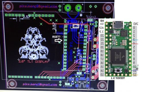

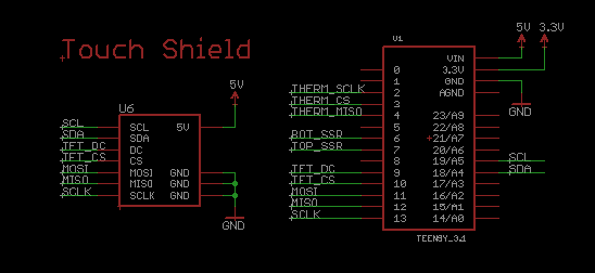

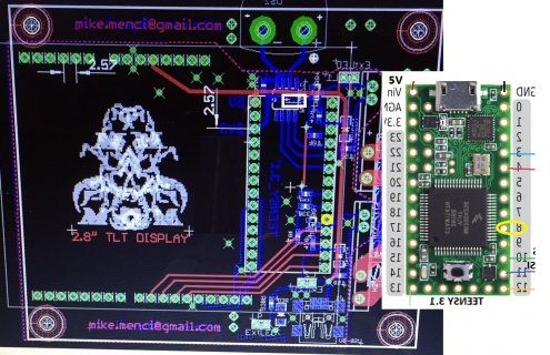

Here the PCB ;
I have no need to use SD card.... touch screen cs(8) D10 D11 are connected !
or is this missing ?

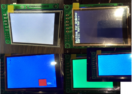

I did some more tests with Teensy 3.1 - Arduino 1.0.6 and I get following out from sketchbook/libraries/Adafruit_ILI9341;
-The screen color changes only ............
- at graphicstest schreen hangs at "waiting for Arduino Serial Monitor",....

On graphictest did you ever plug your Teensy in to the USB port and start up the Arduino Serial monitor? That screen is done as part of the sketch setup:
  tft.begin();
  tft.setTextColor(ILI9341_YELLOW);
  tft.setTextSize(2);
  tft.println("Waiting for Arduino Serial Monitor...");
  while (!Serial) ; // wait for Arduino Serial Monitor
  Serial.println("ILI9341 Test!");

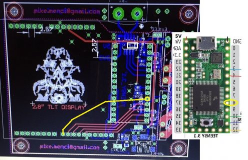

As for slider not sliding, again I mentioned, I could not see on your board if you have pin 8 hooked up. This is the chip select for the touch controller (I believe yours was the resistive touch).
You should try working through the steps up on the Adafruit learn site: https://learn.adafruit.com/adafruit-2-8-tft-touch-shield-v2
If yours is the capacitive touch, I have not done anything with that. But I know it requires I2C pins
Hello Kurt
I did the hook-up of pin 8 and I am getting better response now - slider is sliding now...
That certainly seems to be working.
What happens when you select the serial port (Tools > Serial ports) and then open the serial monitor?
Another thing to test, if you can, is the output of IC5 (AXP803). It's supposed to create the reset signal for the display. If it's working, you should have 3.3V on the "TFT_RST" signal.
That AXP803 chip might have a delay, where TFT_RST is held low for a short time. On the Arduino shield, it connects to the Arduino's reset, to prevent the Arduino board from booting up. But Teensy will automatically boot up very quickly (much faster than any Arduino). Normally fast booting is nice, but if you have something like AXP803 keeping the hardware from being ready for a short time, you may need to add a delay before initializing the display. Usually such problems manifest as code working after you Upload in Arduino, but then they appear to not run when you power the board up without Arduino.

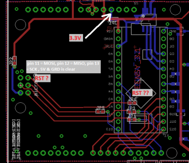

Hello,
To add microSD card pins to Teensy from back side of 2.8LCD;
TFT display and SD card will share the hardware SPI interface / so pin 11 = MOSI, pin 12 = MISO, pin 13 = SCK , 5V & GRD is clear ***
but RES ?? Where to connect on Teensy3.1?
and is there 3V3 needed ??
Thanks,
Mike

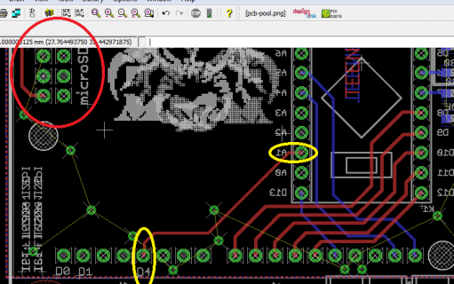

Connect the chip select for the sd card, it's pin D4 on the shield. With A1/D15 from the Teensy 3.1 for example.

So here we go again - like this ?
Because TFT display and SD card will share the hardware SPI interface
pins; 11 = MOSI, pin 12 = MISO & pin 13 = SCK,
I do not need to wire-up TLT shield ICSP connector ? Correct ?
And the GND & 5V leading to TLT will be used as well for 3.3V power supply for miniSC_card -correct?
Thanks,
Mike
