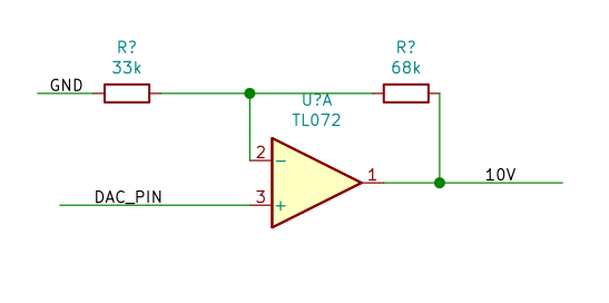

This is a question regarding electronic circuits rather than code, but I'm posting it in case someone can provide some tips.
I want to amplify the signal of the MCP4728 DAC from Adafruit to a range from 0 to 10V. I'm using a TL072 op amp with the current circuit
And this is the code:
I'm sending messages from the serial monitor like this one "0c2047v" which assigns the value 2047 to channel 0. The readings I get from my multimeter from the DAC are correct but the readings I get from the op amp are correct only for values above 1100. If I send a value less than 1100 the op amp starts raising its voltage and when I send a 0 value the op amp outputs 11.71V. I'm using a 12V power supply for the op amp.
Anyone knows why this is happening?
