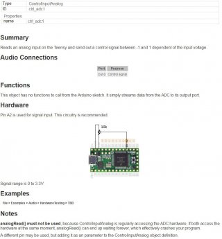

I made a suggestion like you described in the attached index.html file
It does not need an update rate in the same way as the adcin object.
Once every cycle is enough from a user interaction standpoint I think.

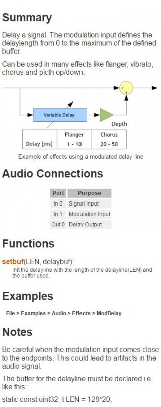

While I was a the task, I also added another suggestion.
It is a variable delayline with a control/modulation input.
This is made by @B.Jaquot and the tread can be found here: https://forum.pjrc.com/threads/34194-Changing-Delay-time-without-distortion?highlight=modulated+delay
The source files can be found here:
https://github.com/Jacquot-SFE/Synth-drum/tree/master/teensy-based/fx/cosmic-delay-sketch
mod-delay.h/cpp
I have tested the files and they work. But maybe they need some polishing..
At least I made a cool pitch/up down effect using this algorithm. The only thing to be aware of is to avoid getting close to 0 delay. That gives artifacts in the sound.

What you've described sounds exactly like the ADC object we already have, but with the high pass filter disabled and the reference changed to 3.3V.
Please understand I have a strong sense of restraint about adding redundant objects to the library. Many, many more objects are planned, so the already long list will grow much, much longer over the next year or so.
There's a phrase from the github folks that goes something like "anything added dilutes everything else". I strongly believe in this philosophy when it comes to GUI design.
Yes, a signal controlled delay line has been on my todo list for quite some time.
Yes, I have that one and many others on a long list to merge into the library later this year. That "some polishing" part usually turns out to be quite a bit of work. So far, in late 2016 and so far in 2017, Teensy 3.5+3.6 and USB host for 3.6 have taken priority over audio library development. I will get back to the audio lib "soon"...
