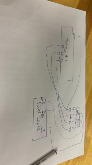

My setup using CAN waveshare (SN65HVD230-CAN-Board), CAN FD pcan cable, and teensy 4.1.
OK, start with the basics:
Do you have a terminating resistor on your CAN bus? You need ~120 ohms between CAN high and CAN low. You can get away with less and depending on the speed often more if you are limited in what parts are available.
Is your bus correctly configured? You say CAN-FD but then your configuration implies a classic CAN 2.0 bus setup rather than CAN FD.

The photo of the wiring connection doesn't look right.
Looks like you are using pin 24 and 25. Those are UART pins, not CAN.
You need to use pin 0,1 for can2. pin 30,31 for can3 and pin 23,22 for can1
You need to use the CAN port of the Teensy. On the card it is shown in pink.
So you need to wire up like this:
For CAN port can1
CRX1 on pin 23
CTX1 on pin 22
For CAN port can2
CRX2 on pin 0
CTX2 on pin 1
For CAN port can3
CRX3 on pin 30
CTX3 on pin 31
So the RX pin of your CAN transceiver need to connect CRX1 pin 23 of the Teensy
TX pin of your CAN transceiver need to connect CTX1 pin 22 of the Teensy

Considering my aim to send can fd messages
You keep saying CAN-FD however all of your code and packets you are trying to send are CAN 2.0.
Only CAN3 supports CAN-FD, all 3 CAN interfaces support CAN 2.0B.
CAN 2.0B is the interface that is normally meant these days when someone says CAN. That is 11 or 29 bit IDs, up to 8 bytes of data and baud rates up to 1 Mbit/s
CAN-FD is backwards compatible with CAN 2.0B and can send/receive CAN 2.0B format packets but adds the ability to send up to 64 bytes of data in a single packet and to increase the baud rate during the data portion of the packet up to 8 Mbit/s (although lots of parts are limited to around 5 Mbits/s).
So which is it? Because if you need CAN FD then you need to configure things like what the higher data baud rate is and you need to ensure you're on the FD capable CAN port with a CAN transceiver chip that can handle the higher data rates.
If you don't need FD then you should probably stop stating that as a requirement.

On PCAN-View you should see something like this:
With your error on PCAN-View, it could be your wiring to the CAN transceiver is not right.
Which CAN transceiver are you using ? Is it CAN FD compliant ?
Post a photo of your setup.
