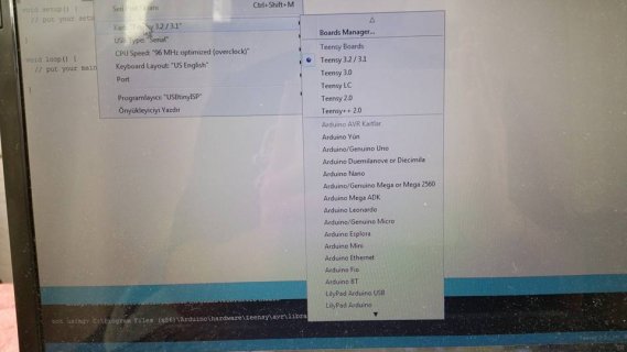

Can you show a screenshot of your Tools > Boards menu?

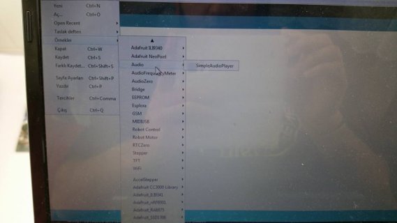

Edit: Or, perhaps you have another library in your Documents/Arduino/libraries folder? Anything you install there will override all the libraries inside Arduino. If you have a non-Teensy lib named "Audio" in that location, it will interfere.
