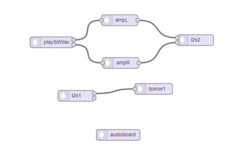

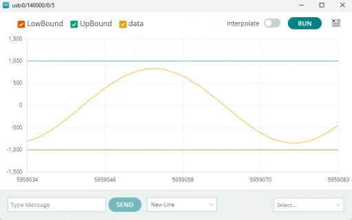

Hello,
I don't know what happening but I either stumble on a bug, or more likely, I'm missing something obvious. As part of a larger project, I'm trying to play a wav file from the SD card (right now a 1000Hz Tone) through the headphone/lineout outputs while, at the same time, reading the line in. The line in (via the audio queue) is being sent to the Serial Monitor. It doesn't have to be perfectly continuous, I just need about 50 ms worth or 18 audio queue packets. I had this working last week so I don't know what happened as I can't think of whats changed. I do think I updated the Arduino IDE to the newest version (V2.2.1 updated 4 days ago). Has anyone else experienced this issue and how did you solve it.
Thus far I've tried tested this code using 2 different computers, and two different Teensy/audio board setups (Teensy 4.1 & Audio RevD Board and a Teensy 3.5 and Audio RevC board). Same results on every combination. I've also disconnected everything to make sure I didn't cross any wires.
I'm hoping its something stupid I'm missing but I haven't been able to figure it out.
I've attached a screenshot of the Audio System Design Tool, a screenshot of the output of the Serial Plotter and the .wav file I'm using
Thank you,
Steve

      // Serial print data to Arduino Plotter
      for (int i = 0; i < bufferleng; i++){
        Serial.print("LowBound:");
        Serial.print(-1000);
        Serial.print(",");
        Serial.print("UpBound:");
        Serial.print(1000);
        Serial.print(",");
        Serial.print("Data:");
        Serial.println(data[i]);

Both input and output should be i2s1, not i2s2.
[ whoops, no I think that's the Audio tool being very confusing and renaming the second i2s input or output as i2s2, which should be i2s_2 ideally... ]
Perhaps temporarily reroute the i2s input to the i2s output and check that works, if so then the playback is likely the issue.
Thanks MarkT for the quick reply.
Are you refering to the two i2s outputs on the teensy 4.x? I am aware of this and i don't think this is the issue. I agree its confusing in the figure from the design tool but I believe I have this correct in the code (See below). I've tried playing around with the naming but no luck.
I will try the routing idea tomorrow.

I ran some additional tests including the pass through test MarkT suggested.
- Pass through test appeared to work correctly
- Tried uninstalling the newest arduino IDE (2.2.1) and installing the previous version (2.1.0). No change
- Played with playSDWav
* Commented out this line and everything worked as expected
* Delayed this line for 4 seconds. As soon as the wav file began to play, the issue returned.
playSDWav.play("1000Hz_CALIB.WAV");
- Changed the names of the line in/out, see below. No change

- Changed the audio input from AudioOutputI2S to AudioInputAnalog seems to work, however, I need the 16bit DAC from the teensy board, not the 10bit DAC on the teensy itself.
- Removed the right output and have the queue connected to the right input. This works However I will need stereo output. A possible workaround could be to use two audio shields and the quad output.
AudioInputI2S            LineIn;           //xy=378,193
AudioPlaySdWav           playSDWav;     //xy=485,429
AudioRecordQueue         queue;         //xy=621,179
AudioAmplifier           ampL;           //xy=699,387
//AudioAmplifier           ampR;           //xy=682,502
AudioOutputI2S           LineOut;           //xy=883,435
AudioConnection          patchCord1(LineIn, 1, queue, 0);
AudioConnection          patchCord2(playSDWav, 0, ampL, 0);
//AudioConnection          patchCord3(playSDWav, 1, ampR, 0);
AudioConnection          patchCord5(ampL, 0, LineOut, 0);
//AudioConnection          patchCord4(ampR, 0, LineOut, 1);
AudioControlSGTL5000     audioboard;     //xy=724,623
It seems like the AudioInputI2S and AudioOutputI2S are somehow crossed in the SGTL5000. Does anyone know if this is true?
A couple more things to try. One is to increase the AudioMemory(25) to, say, 50. If you're using 18 blocks for the queue, that's leaving perilously few for other uses. The other is to move the queue1.freeBuffer(); line to after you've copied the data. As it stands it could be used again before the copy is finished.
Having said that, your code works for me (Teensy 4.1 and Rev D audio adaptor, Teensyduino 1.59 beta 3), though I was a bit flummoxed when nothing worked to start with, then looked closer and discovered you have to send a serial character to allow setup() to proceed. Never seen that one before...
Thank you h4yn0nnym0u5e. I tried both the things you suggested but sadly it didn't work. I did get it working properly by commenting out the "audioboard.volume(0.8);" (line 73).
I agree this is weird in the context of the code I posted. The overall project is communicating via Serial with Matlab, this line is to make the teensy wait for Matlab. I should have removed it for the posted code.
I'm posting my updated code because I've changed enough variable names and added a second queue. I was getting confused going back and forth with what I had originally posted.
It seems to work with "audioboard.volume(0.8);", in setup(), commented out. If any one knows why this line is causing issues, I'd love to know.
